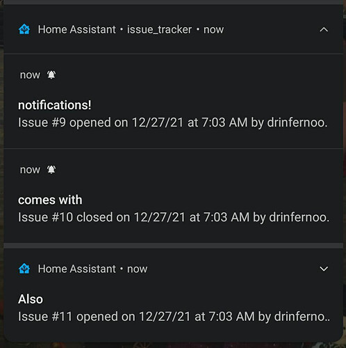

This blueprint is designed to send notifications for the Home Issue Tracker I submitted here:
Simply import this blueprint, and use it with the Issue Tracker I shared there, and you’ll get notifications whenever an issue is opened or closed ![]()
