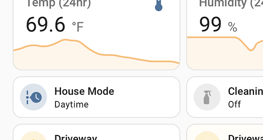

My wall tablet displays show this for the house mode.
I used to have it set that a tap would advance the house mode.
That became problematic as the ui sometimes took too long to respond. The user thought the tap did not take / hit and pushed it again. More often than not it put us into Bedtime by mistake.
I changed it to make it so a button tap on House Mode did a “Default (more info)”.
That gives me this on a tap,
which is not that “pretty”.
To improve my UI Home Assistant could give me a nicer, more pretty selector for my house mode. That said there is nothing wrong with the current one. It is just over kill as the user does not need the history.
