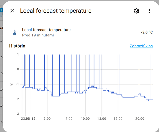

I’m combine two temp value to one it means( netatmo outdoor temp (15min update) and aqara temp(5min) , pressure is taken from aqara(5min)
I 'm getting error in log regarding temp was unvailable or pressure
I think errors are from UI but it has depends on backend because in this time was short temp and some forecast null

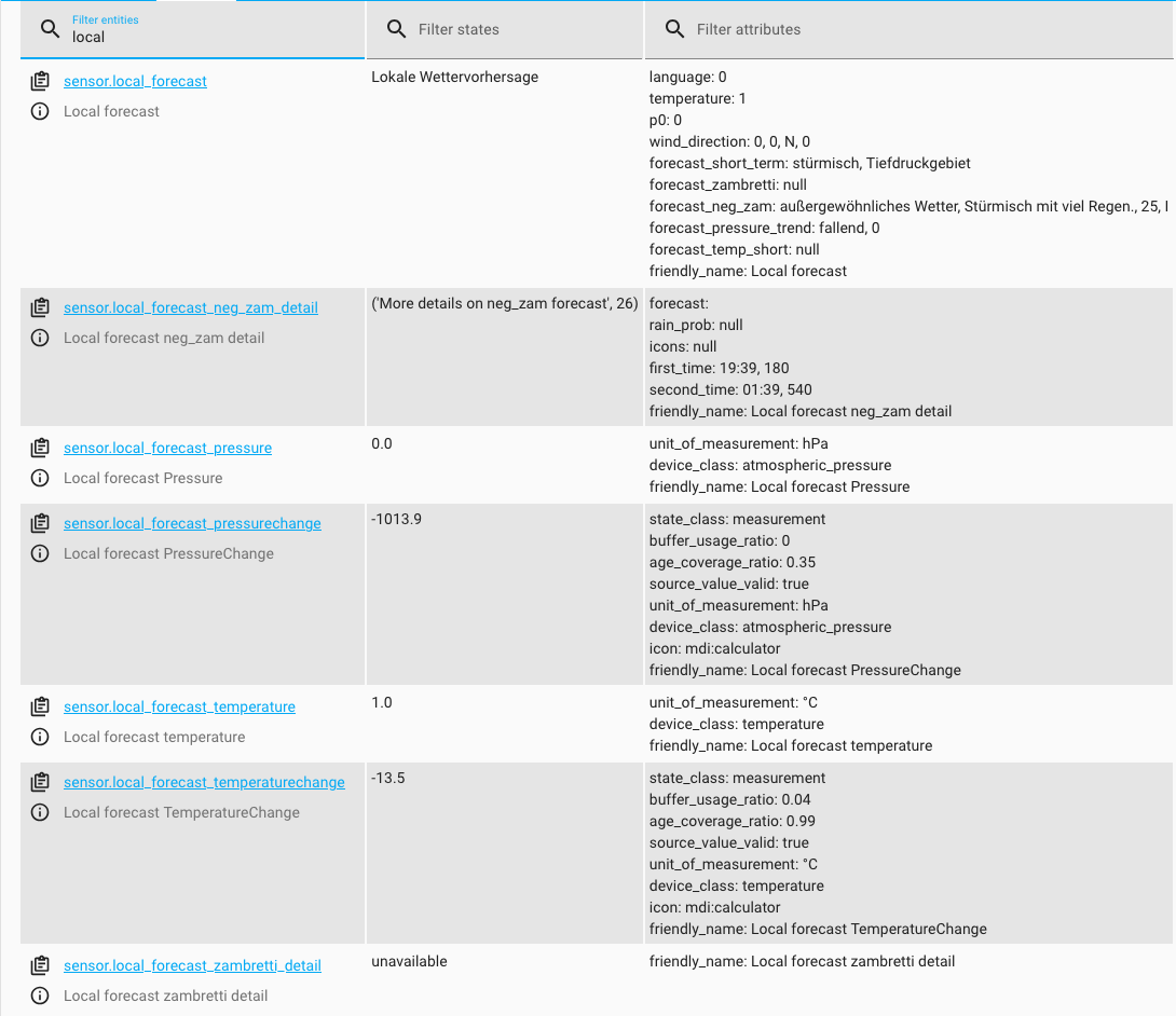

Hi, my you share your the weather_forecast.yaml as is? it’s not clear for me how to edit it, setting the proper variables. Thank you
@HAuser1234 Many thanks for this great integration, exactly what I was searching for.
I’ve installed the weather_forecast.yaml integration, and it’s obviously working well. In the developer tools, I have the “local” states, so I did it correctly, it seems:

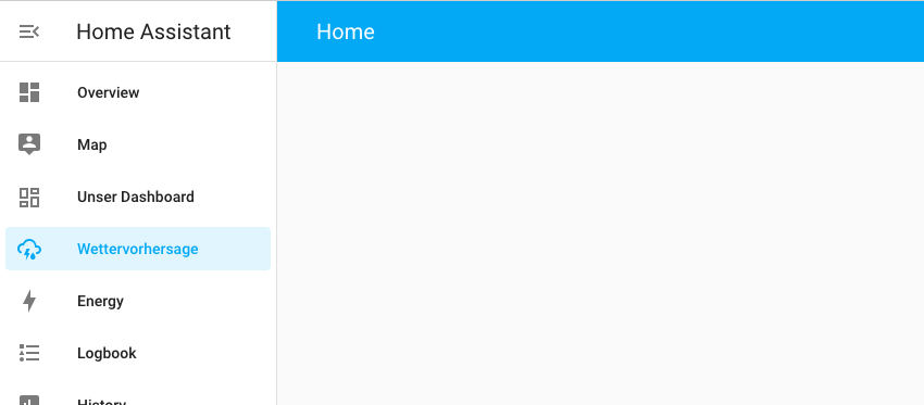

I then created a custom dashboard, edited it as YAML in the “Raw Configuration Editor”, and appended the weather_card_de.yaml YAML code to it. It looks like this now:
views:
  - title: Home
type: custom:vertical-stack-in-card
cards:
  - type: custom:mushroom-title-card
    title: '{{states.sensor.local_forecast.state}}'
  - type: horizontal-stack
    primary: 'Zukunft: {{states.sensor.local_forecast.attributes.forecast_zambretti[0]}}'
    secondary: >-
      Luftdruck:
      {{states.sensor.local_forecast.attributes.forecast_pressure_trend[0]}}
      {{states.sensor.local_forecast_pressurechange.state}} hpa in 3h
    icon: mdi:weather-cloudy-arrow-right
    multiline_secondary: true
    icon_color: grey
    fill_container: false
I’ve also installed the two custom cards that you’re using in the above. I did it properly, as I can see in the browser console that the JS is loaded.
Still, my dashboard is completely empty… :frowning:
Can you please help me understand what’s going wrong?
Many thanks ahead for any help.
Kind regards,
Ralf

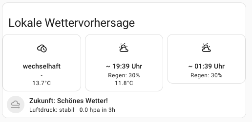

Nevermind, I played with the UI editor a bit and found that your code needs to be embedded in a section.
It looks like this now and is working fine (well, about the prediction accuracy I can make no statement yet…):
views:
  - title: Home
    sections:
      - type: custom:vertical-stack-in-card
        cards:
            cards:
                primary: >-
                  {{states.sensor.local_forecast.attributes.forecast_short_term[0]}}
Here’s the current view:
(BTW, I only have the outside temperature and the air pressure as sensors, maybe I’ll try to integrate further sensors via a public weather API…)
Thank you.

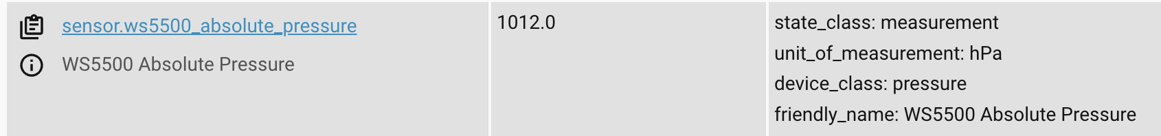

Also, even though I have both absolute and relative pressure sensor entities using hPa, I can’t add them?
Perhaps due to the device_class not being atmospheric_pressure?
UPDATE: I worked around it by adding a template sensor with device class atmospheric_pressure
I removed my post because I found some issues during conversion from yaml to to integration. You want to add as atmospheric_pressure, is it right?
The sensors of my weather station use device_class: pressure, and I can’t select them because the integration only supports device_class: atmospheric_pressure
But like I said, I worked around it by creating a new template sensor with the correct device class.
I’v changed atmospheric_pressure to pressure in line 94 of config_flow.py.
Wich can be found in custom_components\local_weather_forecast. Perhaps this should be default. Then you don’t need to make a extra pressure sensor.
But great work @peter.jurik the intergration is much improved and more user friendly.
