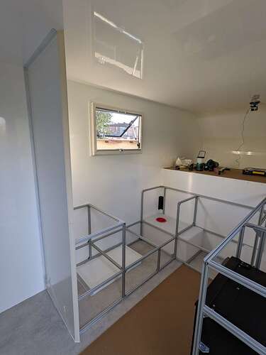

That’s an awesome project! I want to build an automation system based on HA for the truck camper I’m currently building, so I’m definitely following this post and will share details when I actually get to the electrical system, I’m still way behind schedule on the build.
I want to have sensors than monitor temperature, humidity, air quality in multiple places, fans that can turn on or off, lights with wireless dimmers and switches. Monitor the state of my batteries and solar via the bms and victron integration, monitor the water usage (I was thinking with flow meters instead of a water level sensor in the tanks). Have electro valves for the drain… and much more.
This is the current state:
It’s a Ford Ranger with a custom made camper box (by a company). I don’t have access to big trucks here in Italy, so the big challenge is to have the camper as lightweight as possible.
