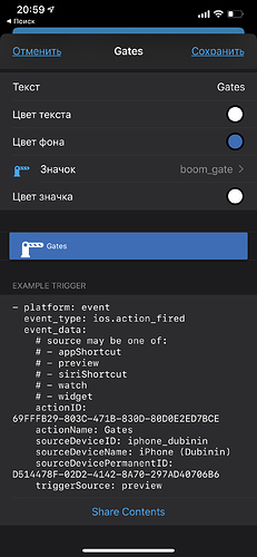

So in the app when creating a widget it gives a template
- platform: event
  event_type: ios.action_fired
  event_data:
    # source may be one of:
    # - appShortcut
    # - preview
    # - siriShortcut
    # - watch
    # - widget
    actionID: 9A3F3B6B-8D57-4E7E-81FB-13151FD5E613
    actionName:
    sourceDeviceID: iphone_dubinin
    sourceDeviceName: iPhone (Dubinin)
    sourceDevicePermanentID: D514478F-02D2-4142-8A70-297AD40706B6
    triggerSource: preview

thats the way i tried, and in the app i named it Gates - but no action fired
