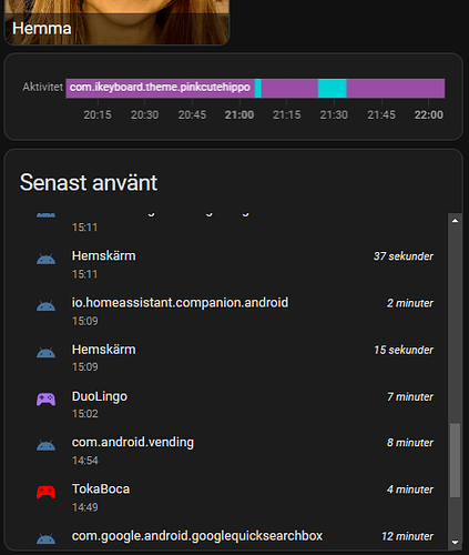

I’ve not done much but it gives me the control I need for now with some logging from her cell and a custom:multiple-logbook-card, below just gives me the apps that I want to keep a close eye on with other colors. Youtube, her games and so on. Then the family link-app gives me the summary of each app nicely in a dashboard
I have various cards with info like notifications and could easily get warning for when ringvolume has been turned off when she leaves home for example

That looks very good. Would you share the code for the cards? My daughter now has a cell phone too…
wich ones? Here is the logger, the one I probably have the most use of, it relies on the custom:multiple-logbook-card, its available through HACS. Most used for checking when she has called ppl and so on. I also have set up an automation that instantly sends us push notifications when she calls with her phone.
The historic bar card is good but the duration is off since the companion not reports when the app exits correctly making one belive they use apps very long…

Yes, that’s exactly what I meant: the custom:multiple-logbook-card.
Thank you very much, I’ll play around with it a bit tomorrow and show you my results.
