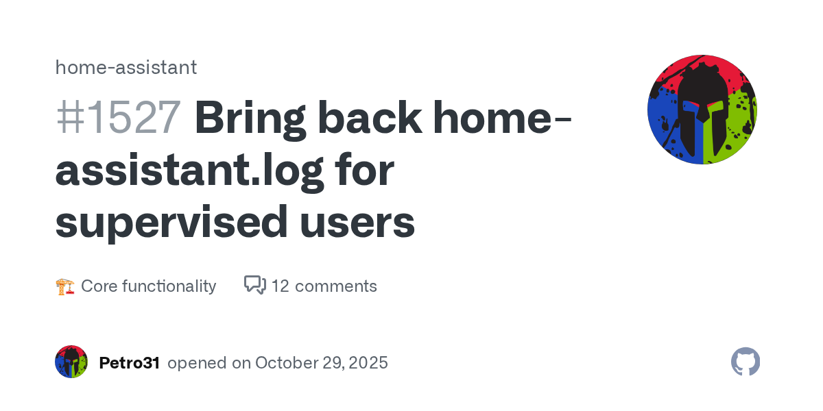

The downside of the removal is that HA needs to run for you to look at the GUI version. If it crashes, you’ll need linux knowledge to get to the logs. The GUI logs are also harder to share with tech support, harder to analyse and it is not really possible to construct a timeline of events when the individual, related events occur more often. A technical discussion about the removal is here:
