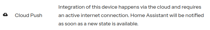

You may be in luck. There are multiple "Tuya" integrations. It sounds like you are using the core Tuya integration, which has the classification "Cloud Push":
