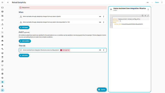

homeassistant.reload_config_entry doesn’t work anymore.
It gives the error no target set even if the target is the same. It has stopped working since 2026.4.1
Even if you click on the integration to reload. It was ok since a few versions ago.

I had to zoom all the way in to spot your issue. homeassistant.reload_config_entry requires an entry_id, but you’re using an entity_id in your automation.
The below is from my own (working) automation to reload the Bring integration.
- action: homeassistant.reload_config_entry
entry_id: 3080e6df9e7ec8a9bdc9dfc966158e03
I’m not sure why you’re saying your automation was ok since a few versions ago. I’m still on 2026.2 and can guarantee that your automation never validated correctly if you were using entity_id instead of entry_id:

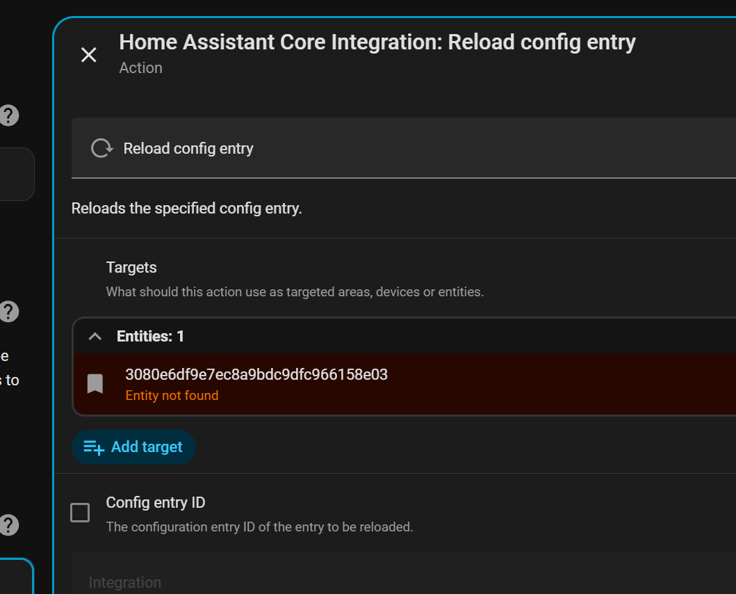

Also with entry id it is not working. As well in Yaml as in visual editor. Even if you click on the good entry since a couple of versions it gives back an error.
Same here. Even if I check the box for config_id and add the correct integration I need to add a target, but the target list only shows entities, not the integration.

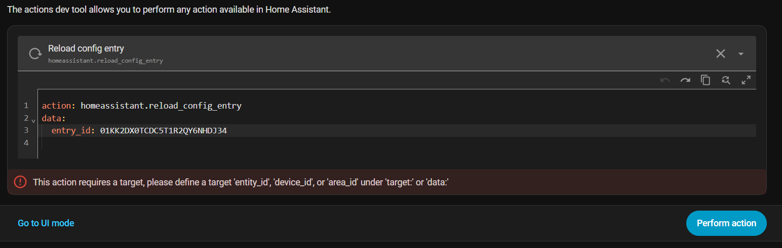

Similar in YAML mode:
entry_id: 0a86a19aa272caea034c628bb77b03a2
Error: This action requires a target, please define a target 'entity_id', 'device_id', or 'area_id' under 'target:' or 'data:'
Neither 'entity_id' nor 'device_id' is allowed in as the data.
Yep, you're right. Since my last post, I updated to 2026.4 and can confirm this issue.
However, there are workarounds for this in both the Automations & the Actions tab in Dev tools:
For Automations, simply ignore the Frontend warning saying "No Target Set". The Action will still work without a target. Just tested the below multiple times & it let me run the actions with no errors:

For the Actions tab in Dev Tools, the call will fail if you don't define a target & an entity ID, however it is possible to switch to yaml mode & replace the entity with an empty array or null. Both the below options are valid & tested as working:
entity_id: null
OR
entity_id: []
I suggest someone raises a bug for this on Issues · home-assistant/core · GitHub
