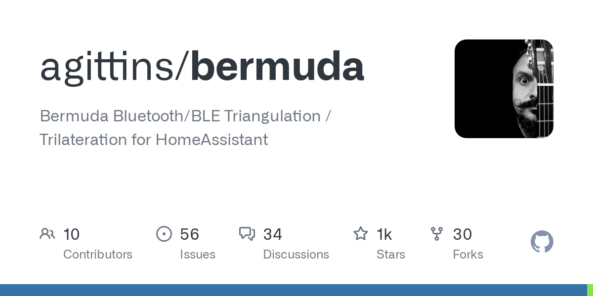

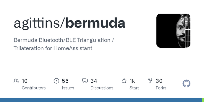

Motion sensors get complicated. What you’re trying to detect is lack of motion, so you have to have some way of knowing that someone should be there. I use Bermuda amongst other things to establish whether I am home:
If I appear to be home but there hasn’t been any movement for 24 hours, emails and texts get sent.
