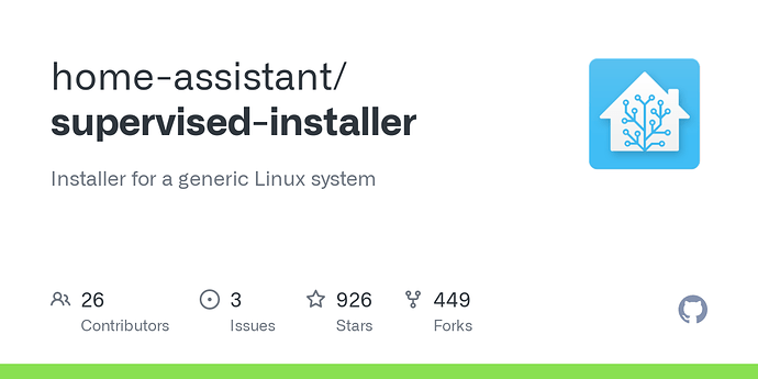

Thanks @BebeMischa - I’ve found this before, but this is just the github page. Not sure how to find the actual image url for docker stack. Hope I’m making sense.
From what I understand home assistant doesn’t officially support a docker supervised install in your own docker environment unless you use the home assistant core docker install. The guide above is the official install method for their supervised docker install.
My understanding of this is that the supervised install requires other dependencies and so it needs to manage the docker environment for you, although tbh I’m not sure all the technical details.
The images for the supervisor version can be found here, although I don’t know the install instructions or if this will work. Packages · Home Assistant · GitHub
Assuming you’re trying to create a supervised HA without using the Debian package, here is a link to the now deprecated installation script. Should get you going if you have the knowledge.
