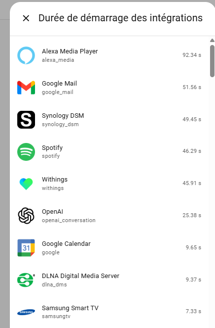

If you go to repairs, you can check how long each integration needs for start-up:
:open_mouth:

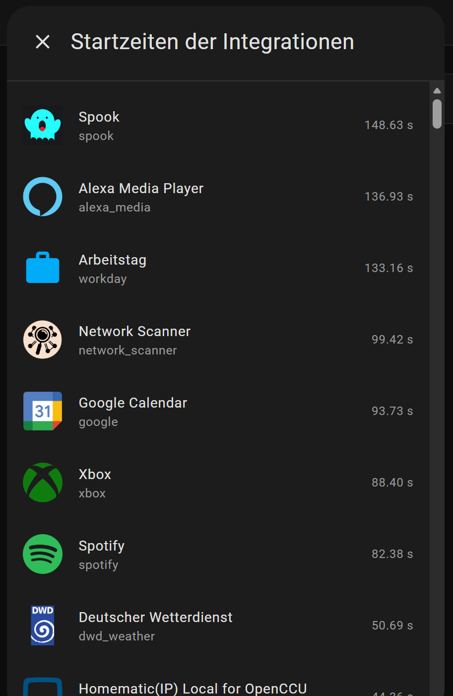

Taht takes really long… Anything I can do about this? Is it only bad hardware?
Could be one of them is making others slow as well. As I said earlier, AMP is the most likely candidate. Disable it and check again. Also good to know what hardware this runs on / what respurces are allocated to the VM. How much memory?

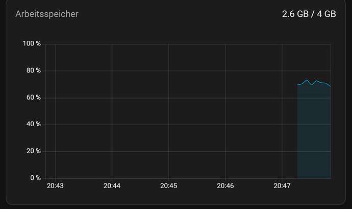

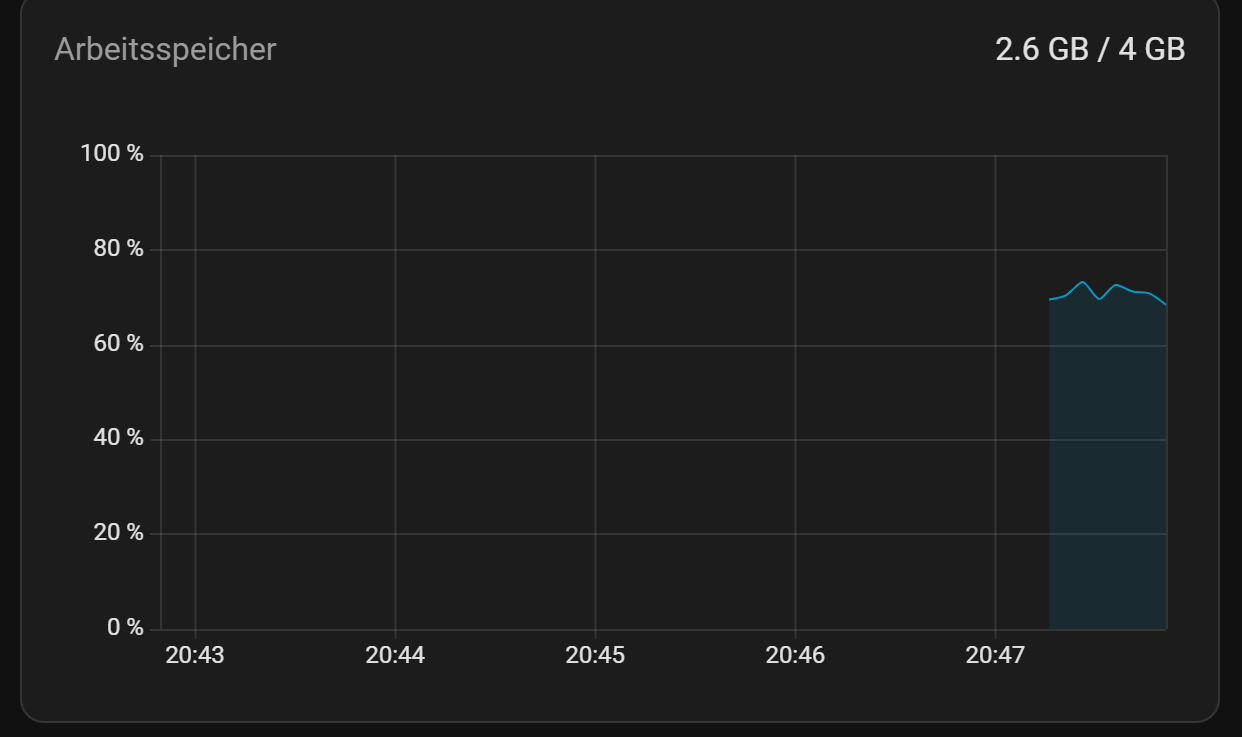

It runs on an Synology DS918+. The VM has 4GB of RAM and can use all 4 Cores.
Lots of addons might be tight on 4 GB. Remember each addon is an application of its own, with their own memory requirements. You cannot see that from the outside, you’ll need to look from withing HA to see how much is used, from the system integration and the (disabled by default) entities of the supervisor integration.
This is what Home Assistant Hardware Monitor is saying?

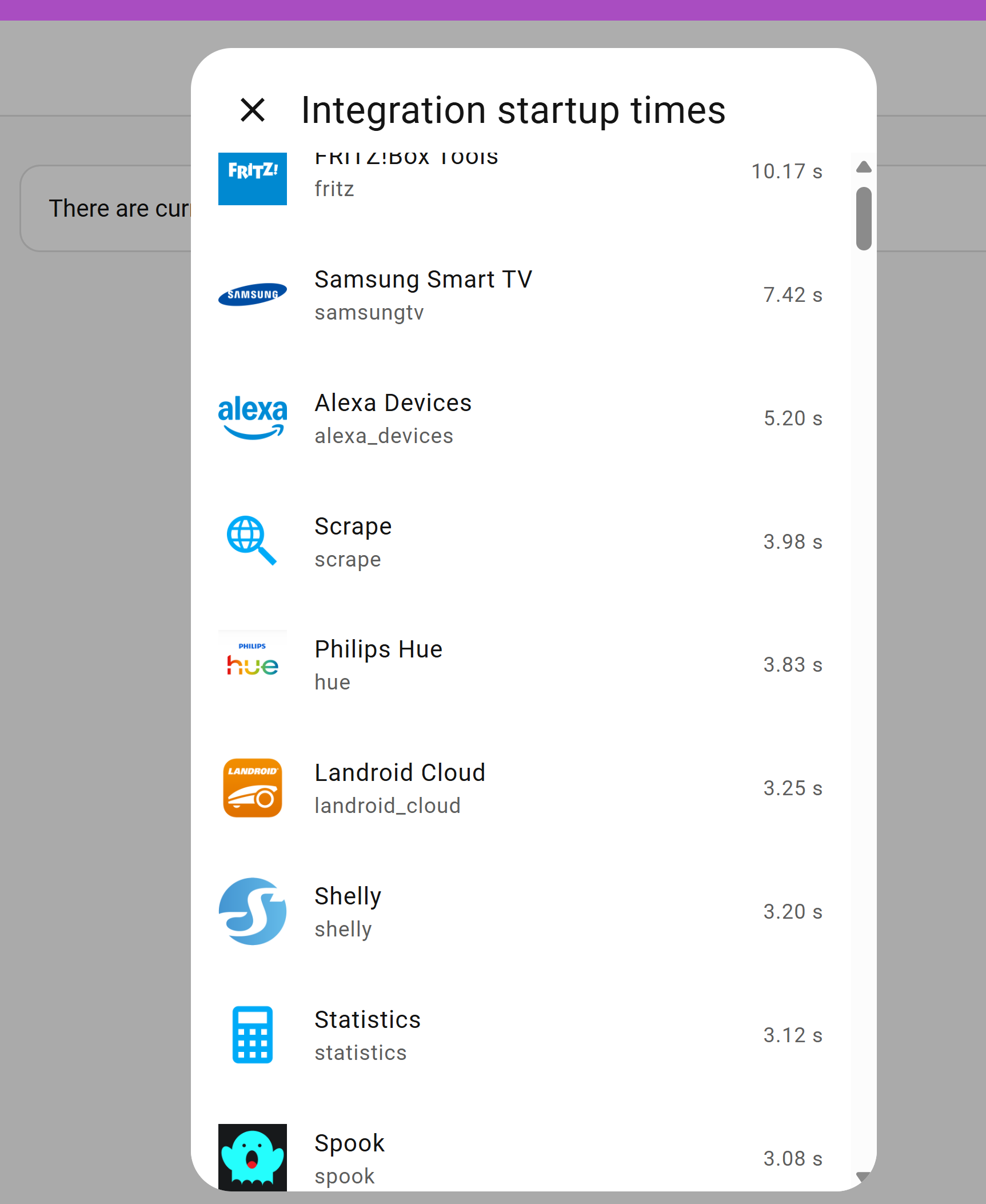

Thank you for all your responses. Just got to understand my problem a bit better.
Here are my startup times
