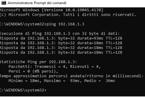

I had to wait, due to the limitations of the forum for new users, to be able to insert this other screenshot.
You pinged the host from the host…that should always work,
I find it a bit weird though it is more than 10ms ??
Since this is the local address, that should be less then 1ms…
This is my local ping, even less than 0.1 ms ![]()

Are you sure 247 is the host?
Can you ping HA [192.168.1.245??] from the host [192.168.1.247??] (or from any other machine in your network that is)
And how about opening http://192.168.1.245:4357 (which should give you the status of the supervisor:
Ping from 192.168.1.247 (Host) to 192.168.1.245 (VM)
From minipc (192.168.1.247) to notebook connected via wifi on the same network (192.168.1.3)
