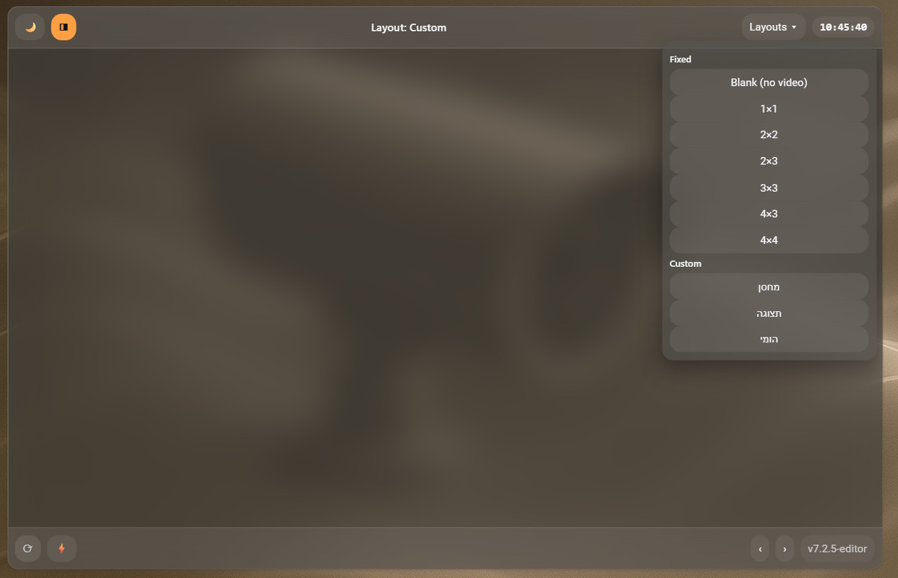

Homeii CCTV Card is a custom Lovelace card focused on multi-camera monitoring with Frigate. It gives you a clean grid of live streams, quick camera switching, overlays, and a powerful visual editor to tailor the UI without hand-editing YAML.
Highlights:
  • Live grid with zoom & pan on each tile.
  • Playback modal (clips/snapshots/recordings/timeline) per camera — powered by the community Advanced Camera Card.
  • Fixed & custom layouts (Blank, 1×1, 2×2, 2×3, 3×3, 4×3, 4×4 + your own).
  • Camera chooser with search (opens under the tile, configurable size/side).
  • Overlays (camera name, quick buttons, alert indicator).
  • Global & per-camera triggers with a proper Home Assistant Action editor (no JSON needed).
  • Full “popups” control: chooser/menu/modal sizing, anchor side, offsets, backdrop blur, corner radius.
  • Styling panel for card/bars/menus/overlay (color, opacity, blur) + RTL name auto-direction.
  • Carousel (auto-page through multi-page layouts).
  • Dual-language UI (English / Hebrew).
  • Version badge, UI scale, and many small quality-of-life touches.

Visual editor (what you can tweak)
  • General: language, live renderer, video ratio, panel height, RTL names, version badge, UI scale
  • Cameras: pick which Frigate cameras to include + per-camera alias
  • Layouts: default layout (fixed or custom), allow which fixed layouts, add/edit custom layouts
  • Overlay & Style: overlay Y & font size, alert icon color, all the color/opacity/blur knobs
  • Bars & Chrome: gaps, clock font, glass/blur for bars and menus
  • Carousel: enable + interval
  • Playback: show/hide :arrow_forward: button, default media (uses Advanced Camera Card)
  • Triggers: global and per-camera lists, with proper HA action chooser (not free-form JSON)
  • Popups: chooser/menu/modal sizing, anchor side, offsets, backdrop, radius
  • Advanced: export/import full config JSON
