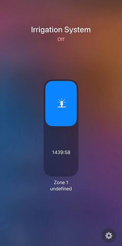

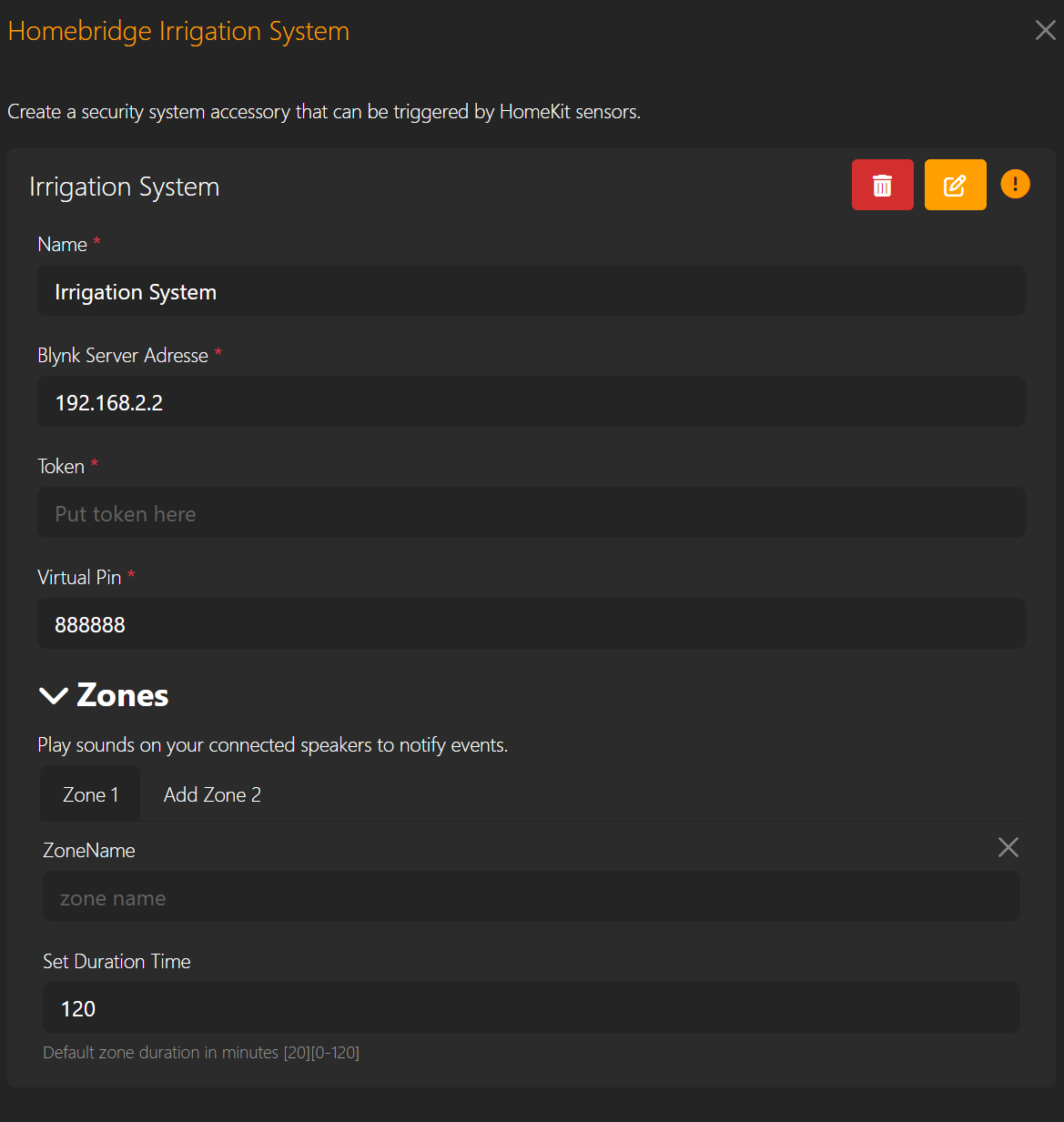

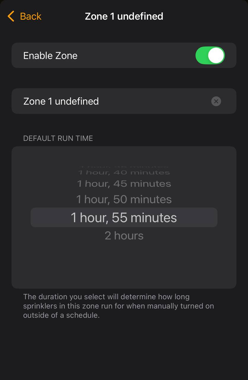

For additional context, here are screenshots of how the slider looks when using the HomeBridge Irrigation System plugin in the Home app:
and from HomeBridge:

I manually edited the code of the homebridge-smart-irrigation plugin to increase the SetDuration.maxValue from the default 7 200 seconds (2 hours) to 86 400 seconds (24 hours). After this small tweak, the Home app immediately picked up the full 24-hour range without any issues
So this confirms that as long as the correct characteristic is advertised, Home app have no problem rendering the extended slider UI

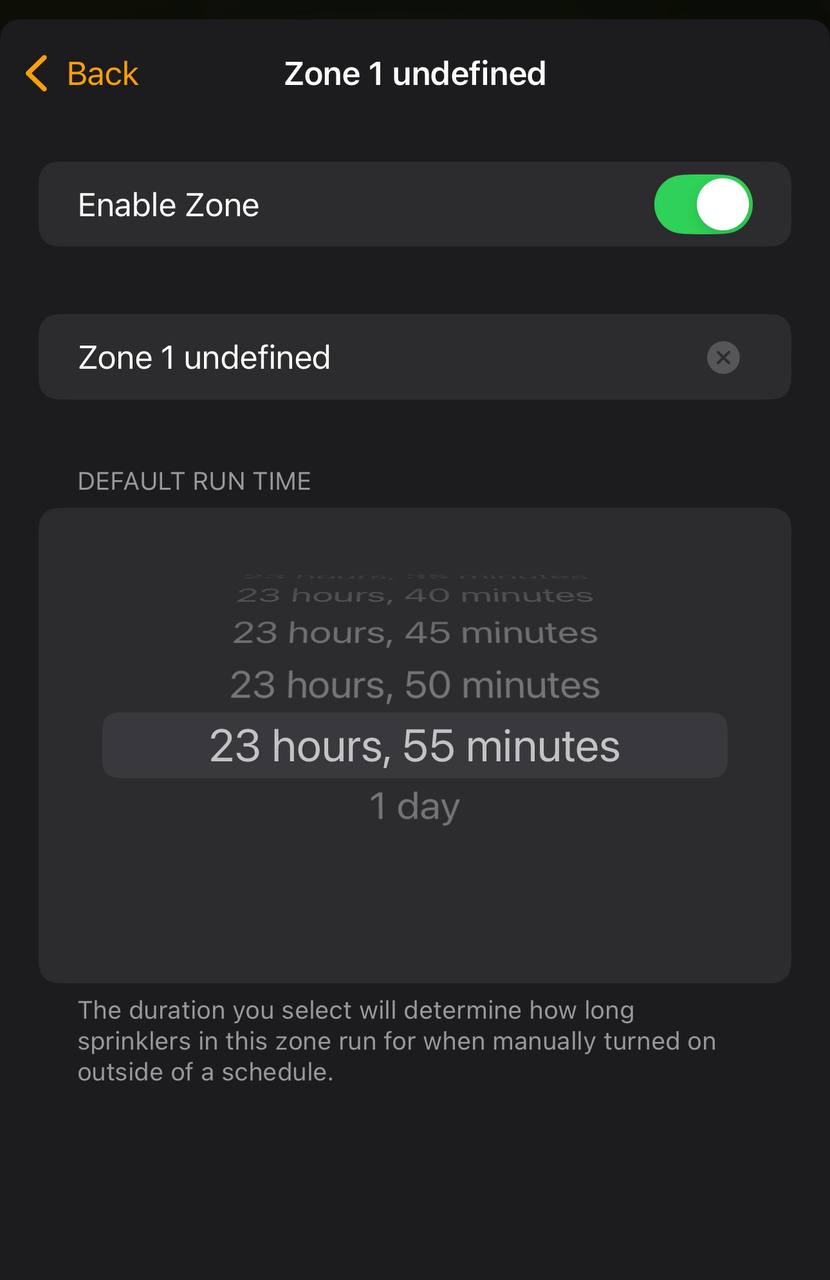

Below are screenshots showing how the slider now appears in the Home app with the updated plugin:

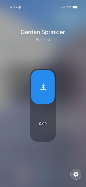

@fabiandev The only remaining issue is that if I turn on the sprinkler switch in Home.app, the counter shows zero until I close out of Home.app and relaunch. Then it shows the correct countdown, and also persists through restarts of the Home.app. Also, if I look at the switch in another Home.app (like from my computer), that second instance shows the right time and then within a second or so the first instance updates to reflect the right timer.
Looks like HomeKit is picking up the linked_valve_end_time sensor value before it is properly updated in HA?
