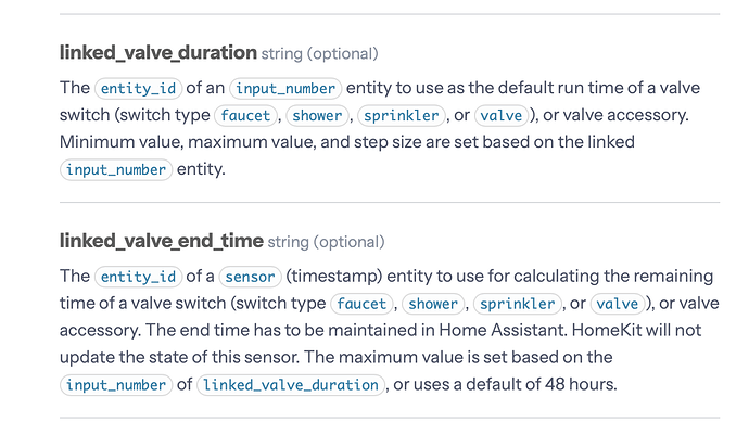

Correct! The input_datetime entity does not include a timezone and cannot be parsed. A sensor of device_class timestamp does include the timezone and can reliably be used for calculating the remaining time.
Also correct! If any state is available for linked_valve_end_time, the HomeKit integration will use it. If the date is in the past, it will yield 0 as remaining time.
What you can do to solve this:
  • Make the linked_valve_end_time state unavailable until it is updated with the actual end time
  • The integration will use the linked_valve_duration as initial countdown in this case
Example how my template sensor looks like with OpenSprinkler:
- sensor:
    - name: Sprinkler S01 End Time
      unique_id: sprinkler_s01_end_time
      device_class: timestamp
      state: "{{ state_attr('binary_sensor.sprinkler_s01_station_running', 'end_time') }}"
      availability: "{{ state_attr('binary_sensor.sprinkler_s01_station_running', 'end_time') != None }}"
I’m using the end time provided by OpenSprinkler, but since it is not available immediately after activating the switch in HomeKit, the entity is only made available once the valve is actually open.
To make sure an initial countdown can be shown without knowing the exact end time yet, the HomeKit integration will use the default run time (assuming this is what will actually be used for later setting the valve end time).

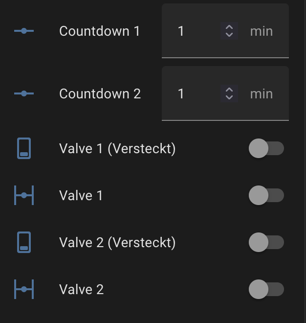

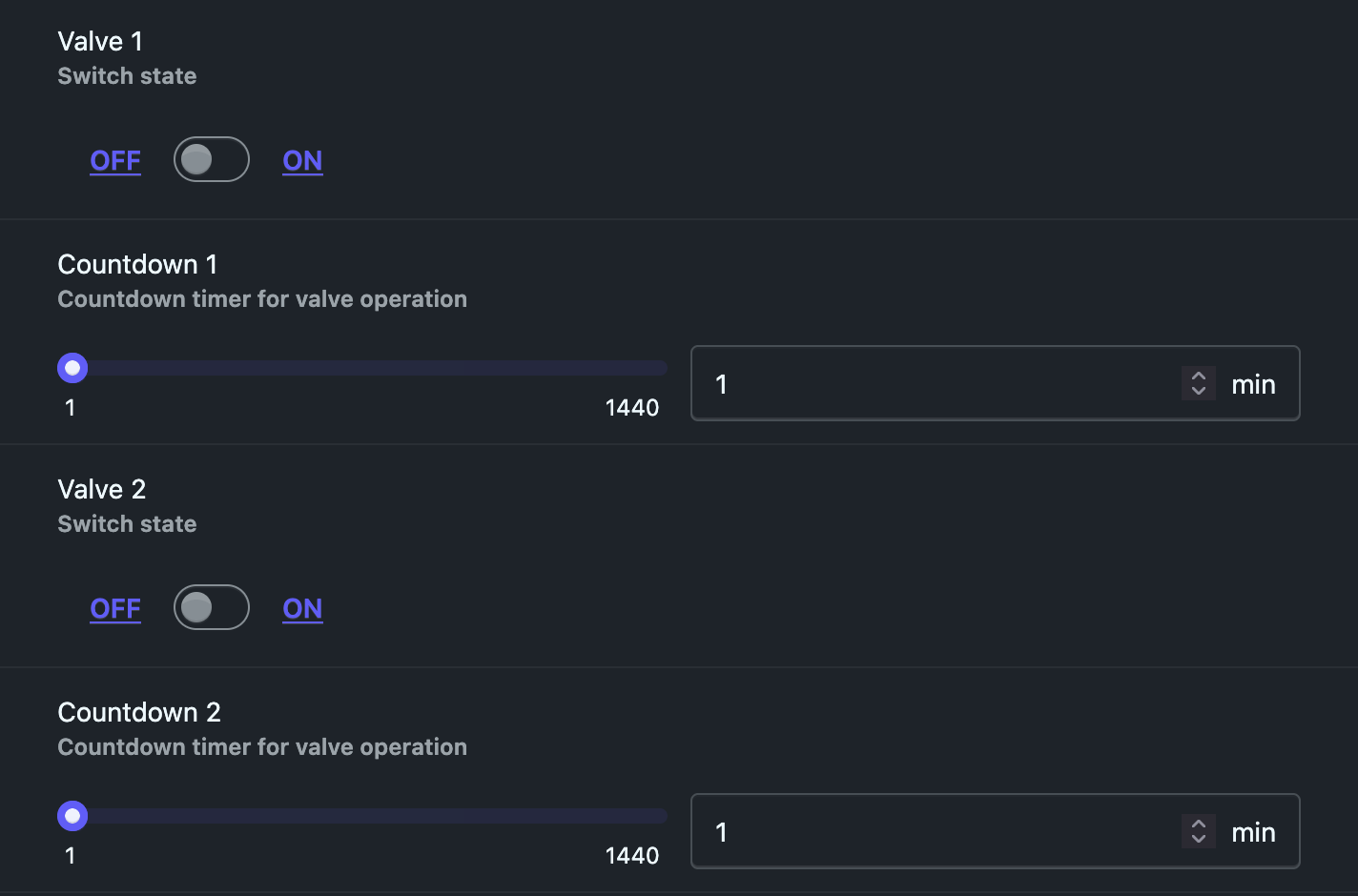

So I am a bit confused how I will make this work when I have follwoing entities in place:
  1. number.garten_wasserswitch_countdown_1
  2. number.garten_wasserswitch_countdown_2
  3. valve.garten_wasserswitch_valve_1
  4. valve.garten_wasserswitch_valve_2
If I set number.garten_wasserswitch_countdown_1 to 4 and click on valve.garten_wasserswitch_valve_1 it will open the valve for 4 min.
I thought I could use this for the homekit integration as well but it looks like I need to have input_number instead of number.
Please can somebody help me how I can set this up correctly? Thx a lot

@redhannes you will need to use the following entity types to make it work with HomeKit:
  • an input_number to provide the default duration
  • a timestamp sensor to provide the end time of the valve (when it will close approx.)
How you could potentially make it work if you need to keep your existing entities as-is:
  1. Create an input_number for linked_valve_duration and use the value for your number entities. How this can be done exactly depends on if your “countdown” entities are actually counting down, or just provide a default run time?
  2. Update a timestamp sensor for linked_valve_end_time when the valve is turned on, and compute the state as now + countdown

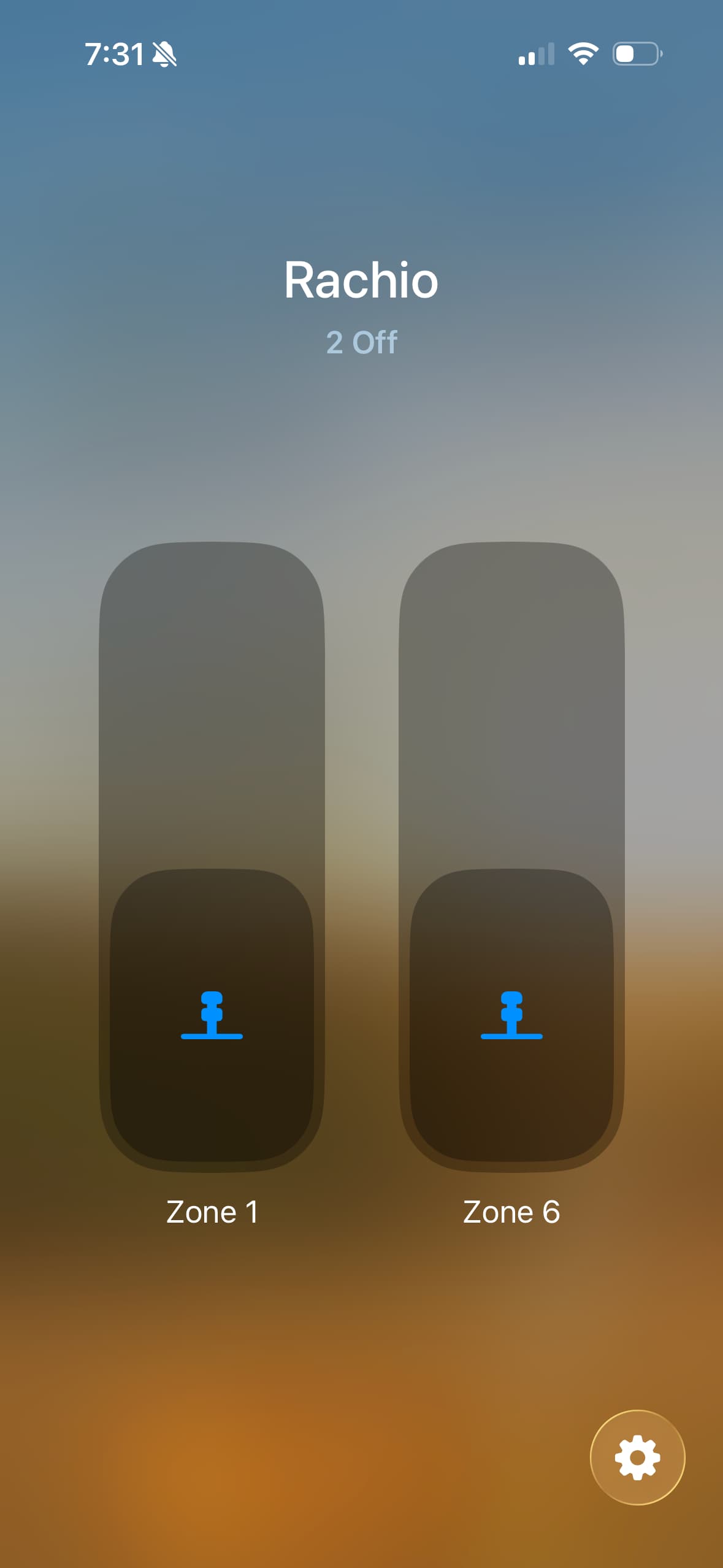

Hi there, I already addressed the multiple-zone issue in my PR
Add irrigation_system type to HomeKit bridge for multi-zone sprinkler support by qthuan · Pull Request #169114 · home-assistant/core
If that go through, then I will update the document for configuration
