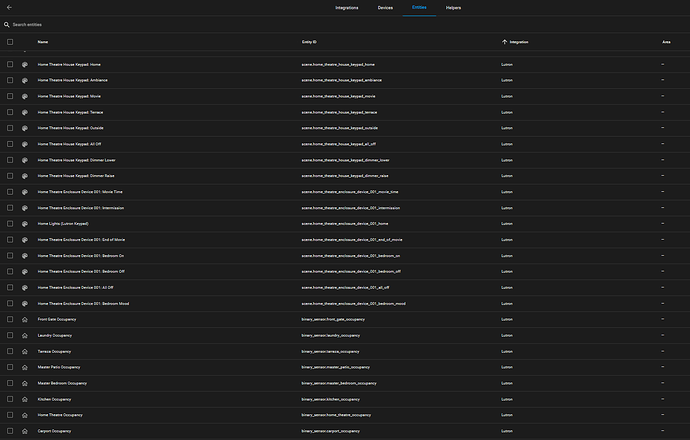

Appreciate the feedback! Spent some time diggin deeper this morning (had an epiphany at 4:30am) and found that spacing (of all things) is CRITICAL in the yaml file! I literally had to put a space between the colon and variable (IP_ADDRESS, USERNAME, PWD) and the whole system came to life.
Now I have to sort through all the devices and scenes from the Lutron side… I have 98 Lutron Devices, and nearly as many scenes to decide upon!
