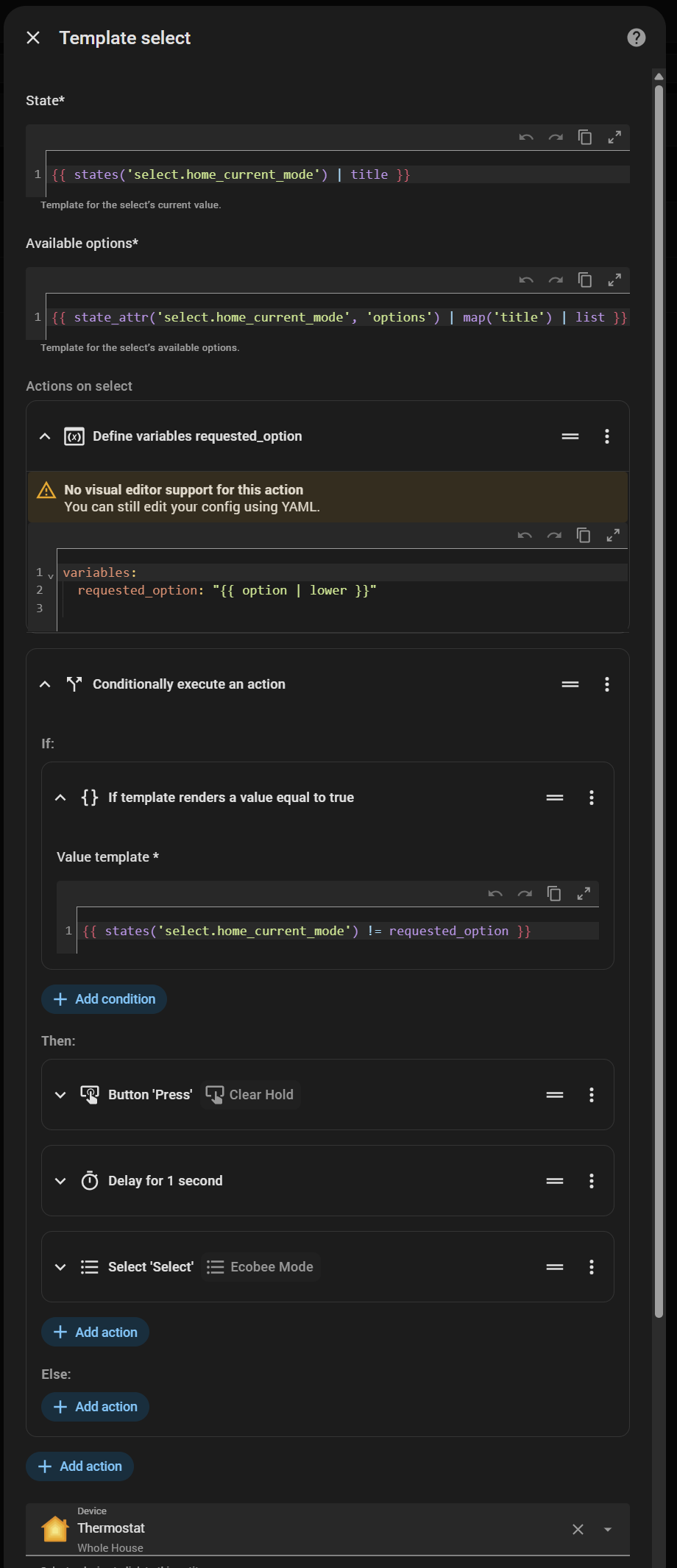

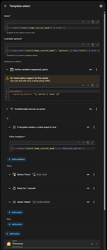

If anybody else is still trying to use the Ecobee’s modes to control temperatures, instead of managing it all directly within HA, can you possibly give the workaround/fix I describe here a try to see if it works for other people?
hmmm, I take it back, this solution seemed to be working like a charm for 10 days and then stopped working 3 days ago for some reason. Not sure what changed or updated.
After some unrelated updates, I restarted HA and this appears to be working 100% again…not sure what was stuck before, but this still seems to be a valid fix/workaround.
How does one implement this workaround?
Take a look at the Template Select Helper snippet about 3/4 of the way down. It should be able to be copy/pasted into your configuration yaml, or you can build the helper manually, which looks like this:
