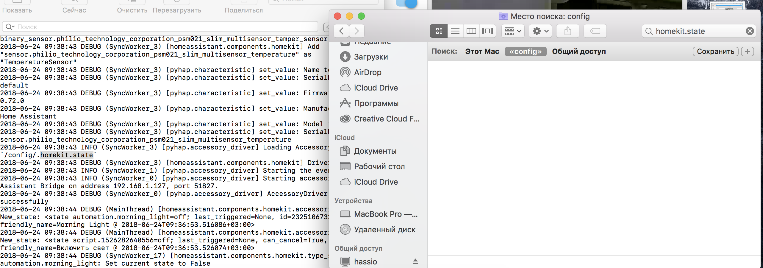

For HomeKit: Try deleting the .homekit.state file in the config folder and restart. That should do the trick.

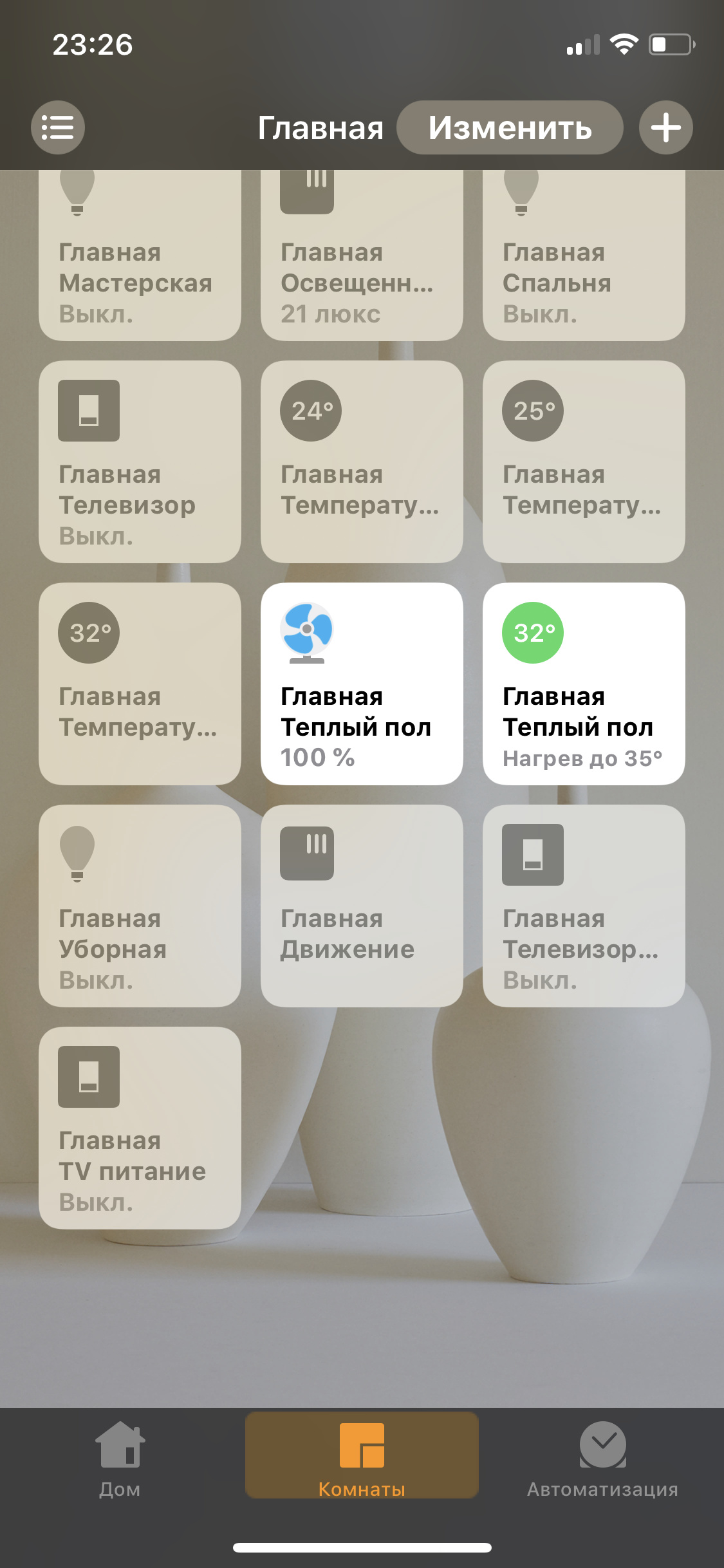

From HA A/C works almost perfect, sometimes it does not do the command. Thermofloor works just perfect.

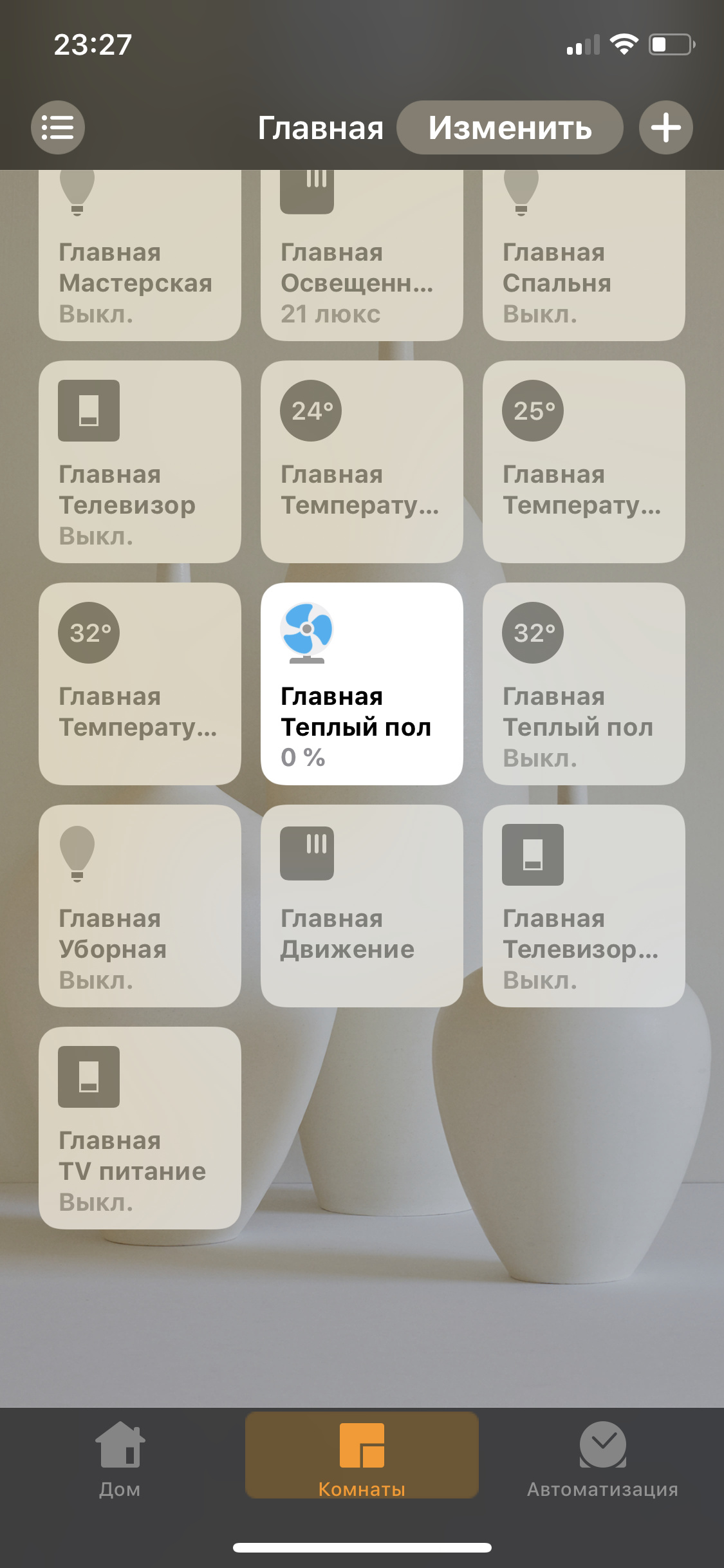

In home app I have 2 items for climate. I try mode heat on 35 degrees, fan on 100% and nothing happens.
Nothing in HA logs and when I open home app again, I see this.
So after updating everything, home app gets from HA that state (off). As it is in HA UI.
I got that with “homekit” addon and “homebridge” addon. Just the same thing.

It is a hidden file, starting with a period: .homekit.state.
The file is called “.homekit.state” mind the dot at the beginning which means it’s a hidden file. You can show hidden files by pressing Cmd + Shift + . (dot) on your Mac.
Thank you, that info is really useful for me!

Turn off - does not work. Logs:
2018-06-24 22:35:55 DEBUG (Thread-16) [pyhap.hap_server] Request PUT from address '('192.168.1.66', 57033)' for path '/characteristics'.
2018-06-24 22:35:55 DEBUG (Thread-16) [pyhap.characteristic] client_update_value: TargetHeatingCoolingState to 0
2018-06-24 22:35:55 DEBUG (Thread-16) [homeassistant.components.homekit.type_thermostats] climate.remotec_zxt120ru_cooling_1: Set heat-cool to 0
2018-06-24 22:35:55 INFO (Thread-16) [pyhap.hap_server] 192.168.1.66 - "PUT /characteristics HTTP/1.1" 207 -
2018-06-24 22:35:55 DEBUG (Thread-16) [pyhap.hap_server] Request GET from address '('192.168.1.66', 57033)' for path '/characteristics?id=3908308246.12,3908308246.9,3908308246.13,3908308246.11'.
2018-06-24 22:35:55 INFO (Thread-16) [pyhap.hap_server] 192.168.1.66 - "GET /characteristics?id=3908308246.12,3908308246.9,3908308246.13,3908308246.11 HTTP/1.1" 207 -
2018-06-24 22:35:56 DEBUG (Thread-16) [pyhap.hap_server] Request GET from address '('192.168.1.66', 57033)' for path '/characteristics?id=3908308246.9,3908308246.11,3908308246.13,3908308246.12,3908308246.10,1454180423.9,1109394794.9,672597296.9,1394677208.9,672924977.9,2204898984.9,3387430799.11,3387430799.13,3387430799.10,3387430799.9,3387430799.12,632489299.9,671286572.9,1108870504.9,671614253.9,3902737675.11,3902737675.12,3902737675.9,3902737675.13,3902737675.10,2725776140.9,1845106148.10,1845106148.11,1845106148.13,1845106148.12,1845106148.9,671941934.9,672269615.9,3615171322.9'.
2018-06-24 22:35:56 INFO (Thread-16) [pyhap.hap_server] 192.168.1.66 - "GET /characteristics?id=3908308246.9,3908308246.11,3908308246.13,3908308246.12,3908308246.10,1454180423.9,1109394794.9,672597296.9,1394677208.9,672924977.9,2204898984.9,3387430799.11,3387430799.13,3387430799.10,3387430799.9,3387430799.12,632489299.9,671286572.9,1108870504.9,671614253.9,3902737675.11,3902737675.12,3902737675.9,3902737675.13,3902737675.10,2725776140.9,1845106148.10,1845106148.11,1845106148.13,1845106148.12,1845106148.9,671941934.9,672269615.9,3615171322.9 HTTP/1.1" 207 -
I have to do some testing before I can get back to you, probably later this week.
Will be waiting.
Thank you for your time.
The tests were done faster then I expected and it seems to confirm what I already thought, that the most likely reason for this issue is the climate platform / the specific thermostat.
As seen in the logs, HomeKit does send all the commands to Home Assistant and they are recognized correctly. E.g.
2018-06-24 22:25:35 DEBUG (Thread-16) [pyhap.characteristic] client_update_value: TargetHeatingCoolingState to 0
2018-06-24 22:25:35 DEBUG (Thread-16) [homeassistant.components.homekit.type_thermostats] climate.thermofloor_as_heatit_thermostat_tf_021_heating: Set heat-cool to 0
What follows is a service call, that somehow doesn’t work in your case.
If you like, try the following:
  1. Select heat mode from HA frontend, for climate.thermofloor_as_heatit_thermostat_tf_021_heating.
  2. Open the services panel in HA
  3. Select the service: climate.set_operation_mode and as entity: climate.thermofloor_as_heatit_thermostat_tf_021_heating.
  4. For service data, use:
  "entity_id": "climate.thermofloor_as_heatit_thermostat_tf_021_heating",
  "operation_mode": "off"
  1. Click on Call service.
Does this change anything for the entity?
