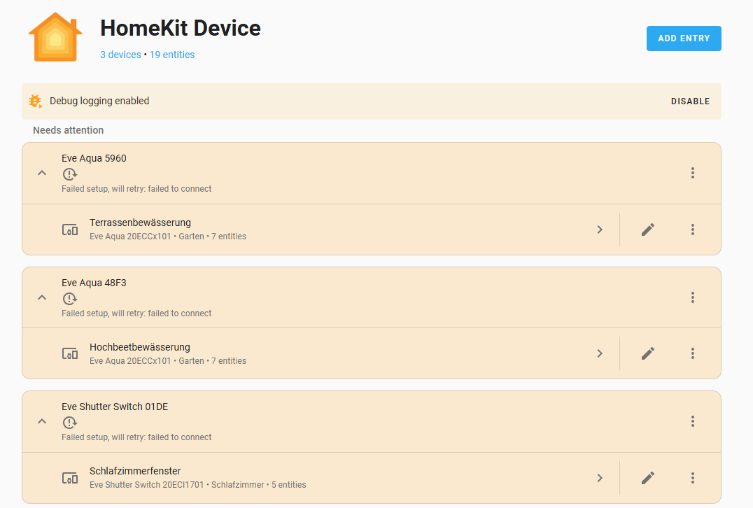

HI,
all my homekit thread devices fail to connect in home assistant since I did the upgrade to home assistant 17.1 (from 16.1) and Operating System 16.0.
I still see in the OpenThread Border Router that all the device are connected via Thread. And all Matter over Thread devices are still working.
I could not find any useful logs only some related to Bluetooth which is not used anymore for these Homekit Thread devices.
Was there any change done regarding Homekit over Thread devices?
Could it be that the devices lost the Thread binding?
I also enabled Debug logs for Homekit Device Integration but can’t see any related logs.
BR,
Martin

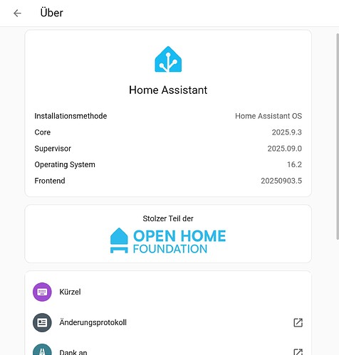

I’m have 4 Onvis Smart Buttons (Homekit over Thread). They’ve alway been sensible to HA-restarts, and sometimes became unavailable for hours. But since the last update they cannot even be connected to my thread network. I pair them with bluetooth and when I hit the “Tread” Button they become unavailable and never come back.
Logger: homeassistant.config_entries
Quelle: config_entries.py:751
Erstmals aufgetreten: 19:56:17 (1 Vorkommnis)
Zuletzt protokolliert: 19:56:17
Error setting up entry Onvis-HS2-7668BC for homekit_controller
  File "/usr/src/homeassistant/homeassistant/config_entries.py", line 751, in __async_setup_with_context
    result = await component.async_setup_entry(hass, self)
  File "/usr/src/homeassistant/homeassistant/components/homekit_controller/__init__.py", line 60, in async_setup_entry
    await conn.async_setup()
  File "/usr/src/homeassistant/homeassistant/components/homekit_controller/connection.py", line 338, in async_setup
    await self.async_update(poll_all=True)
  File "/usr/src/homeassistant/homeassistant/components/homekit_controller/connection.py", line 957, in async_update
    self.process_new_events(new_values_dict)
  File "/usr/src/homeassistant/homeassistant/components/homekit_controller/connection.py", line 971, in process_new_events
    for aid_iid in self.entity_map.process_changes(new_values_dict):
  File "/usr/local/lib/python3.13/site-packages/aiohomekit/model/__init__.py", line 410, in process_changes
    char.status = to_status_code(value.get("status", 0))
  File "/usr/local/lib/python3.13/site-packages/aiohomekit/protocol/statuscodes.py", line 44, in to_status_code
    return HapStatusCode(abs(status_code) * -1)
  File "/usr/local/lib/python3.13/enum.py", line 726, in __call__
    return cls.__new__(cls, value)
  File "/usr/local/lib/python3.13/enum.py", line 1203, in __new__
    raise ve_exc
ValueError: -6 is not a valid HapStatusCode
Can someone help me? I installed all available updates…
