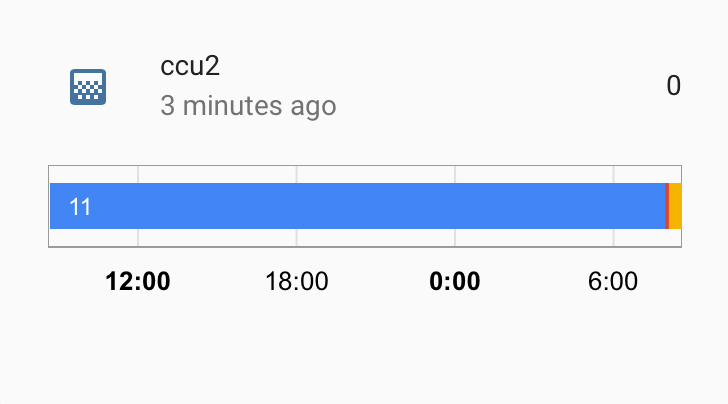

All Homematic devices are found with HA, but I can not see any variables if I click in the frontend on the ccu2 entity:
As far as I understand all boolean variables should be automatically detected and shown there.
