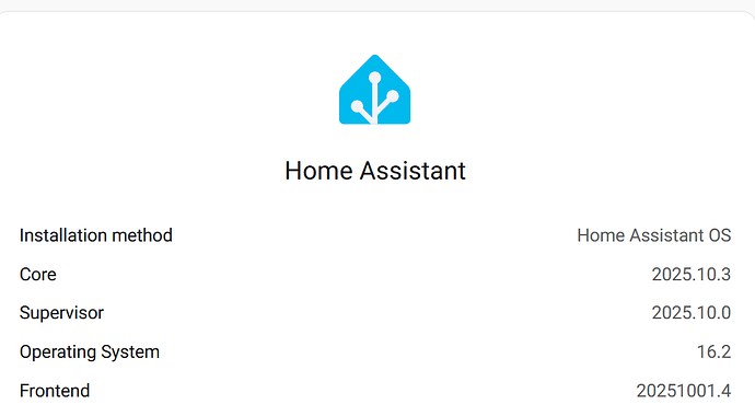

Sorry folks… missed the replies on this thread. I was testing our upcoming Z-NET PRO with ZHA today and ran into exactly the same “failed to connect” error. This new unit was flashed with firmware v8.0.2… so tried a previous build flashed with v7.4.3. The previous version worked as expected. Based on that, we were looking at the new firmware as the culprit. However, we then tried our SmartStick ZB (also flashed with v8.0.2) and that worked too!
After a lot of head scratching and messing about with settings, we realized the HA OS was horribly out of date (so much so it was unsupported), so updated that and the HA core and tried again. Bingo! Works fine now. So, if anyone is still battling with this (after a year!), give that a try. Granted, the hardware is a bit different, but the error is the same so might be worth a try. Here is the platform info for the tested system:
