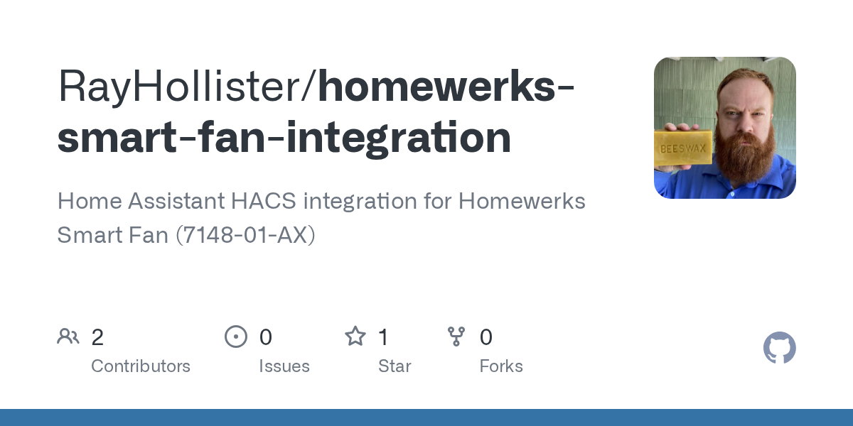

I ended up here while trying to reverse engineer an integration with Claude. Claude suggested trying the Tuya integration first based on this thread and a few others.
It seems like some Homewerks devices are Tuya based and some are not. Has anyone successfully connected a Homewerks 7148-01-AX using the Tuya integration?
I spent about an hour on this last night before giving up. I was able to put the fan into pairing mode and tried adding it manually in Tuya, but it kept reporting the wrong WiFi network and telling me to look for SmartLife-XXXX or SL-XXXX SSIDs.
The fan’s SSID shows up as “Bathroom.” As far as I know, it has always used that name.
Update: Claude and I spent about an hour monitoring the network traffic, capturing packets and writing a custom HACS integration for this fan.
So far, it appears to be working reliably for basic local control. That said, this is based on reverse engineered behavior and undocumented endpoints, so use at your own risk.
If anyone wants to experiment with it, the code is here:
