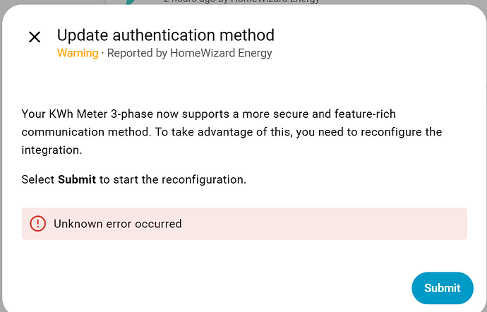

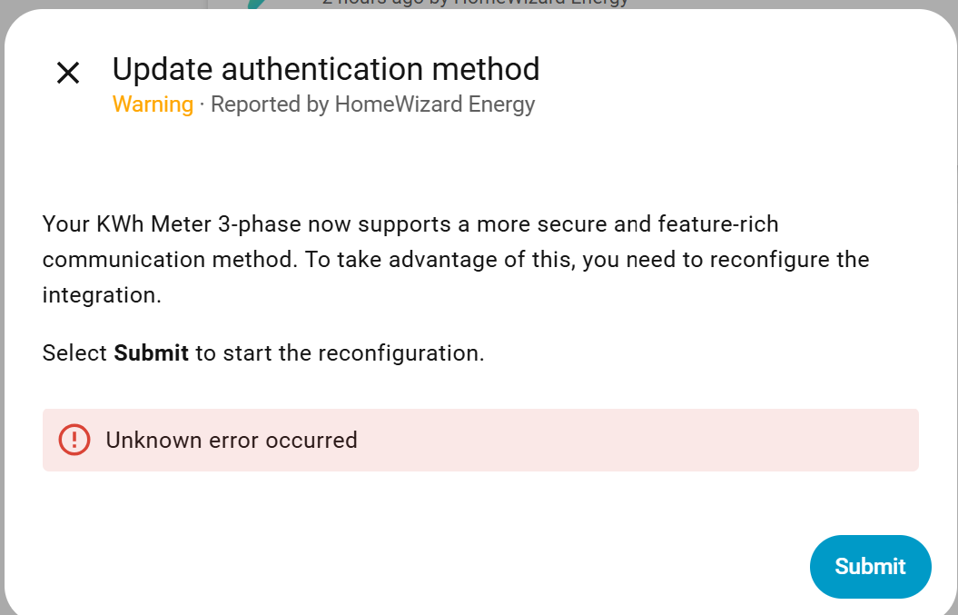

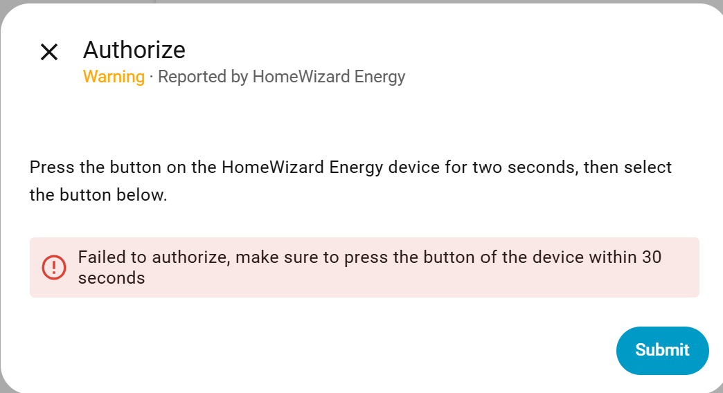

Yes, of course! Okay, so I moved my Home-Assistant to a new server. And after a restore I got this message (in the screenshot). So, I followed the instructions, press the button on the P1 dongle and press submit in Home-Assistant. But, no matter how many times I try, it’s not working. On the other hand, it IS reading info from the P1 and the 3Kwh device.
Software versions:
P1: 6.0203
3kWh: 5.0011
I keep getting this:
And this for the P1:
Okay! Everything seems to be up to date, so that is not an issue. Can you take a quick look at the logs?
The best thing you can do is to go to the HomeWizard integration, hit the three dots in the top left, and enable debug logging. Then try to update the authentication method.
If you then disable the debug logging, a file will be downloaded. DM that to me (as it may contain sensitive information). I will take a quick look at that to decide if this needs to be an issue on GitHub.

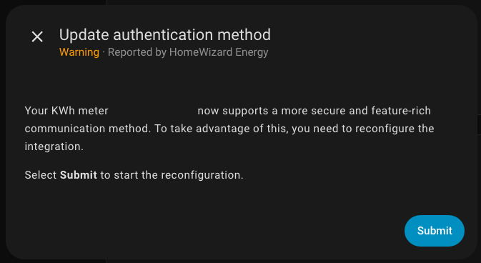

I have one 1 phase and one 3 phase kWh meter, only for the 1 phase kWh meter I got the following warning message reported by HWE:

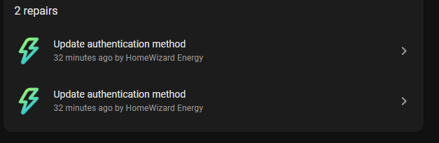

For me it worked. I do have 9x the 1phase version and the fix prompt doesn’t show which of these it is… So its quite annoying to apply as I need to press the pairing button all one by one.
I have two left I can’t seem to switch, as I don’t know which ones they are it’s really hard to diagnose where it goes wrong.
I am aware of some issues related to the repair. I will work on fixes for that as soon as possible. For more information, see HomeWizard update authentication repair does not handle multiple simultaneous repairs properly. · Issue #154012 · home-assistant/core · GitHub
