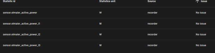

The main issue i am unable to add the total consumption from my power meter to the Energy Dashbord (Add Consumption). The entity will not list in here.
The dev tool statistics looks like this.
I haven´t made any exclusions to the recorder, not that i am aware off atleast.
