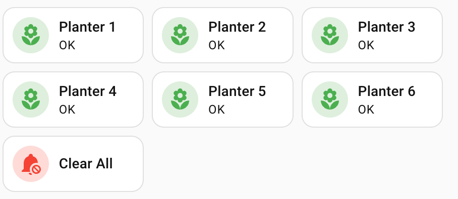

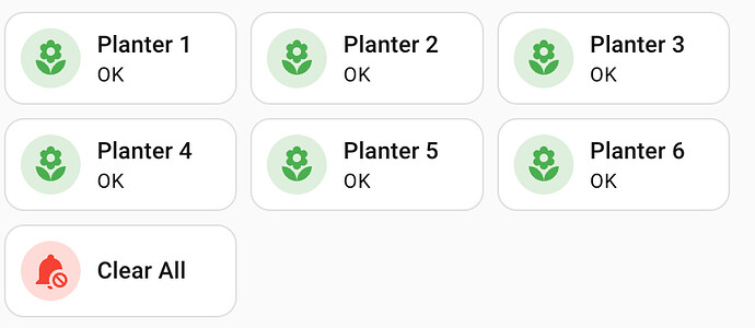

There is a klugy way to integrate Rainpoint Sensors. Using the app, create smart notifications for each sensor – something like when humidity falls below xx% send an email with subject line: Planter X needs watering (you can do one for Replace Batteries as well). Do this for all your sensors. Set up an email in google that’s just for your HA integration and add an app password. Then add the IMAP integration to HA and include your new email. Then you can set up an helpers, automation, script and dashboard card that activates when the email is sent. Attached is what the final card looks like. It will display OK until an email is sent saying that a specific planter needs to be watered or the battery replaced. I have to manually clear the notifications but other than that it works pretty well. I used ChatGPT to help me set it up. Happy to share code and specific steps if helpful.

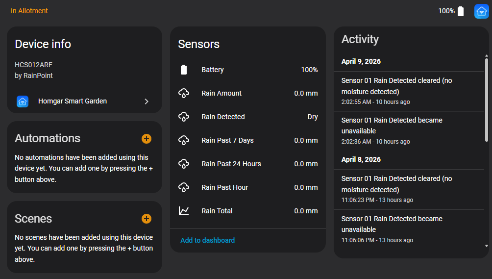

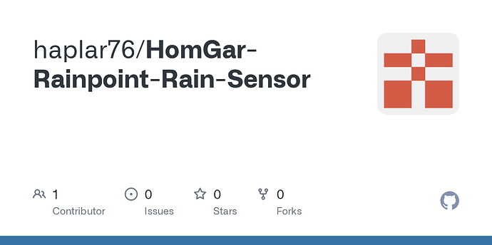

I managed to make corrections to the implementation to get the RainPoint rain sensor model:HCS012ARF and smart hub model:HWG023WBRF to intergrate into HA
I have uploaded the files with change notes here

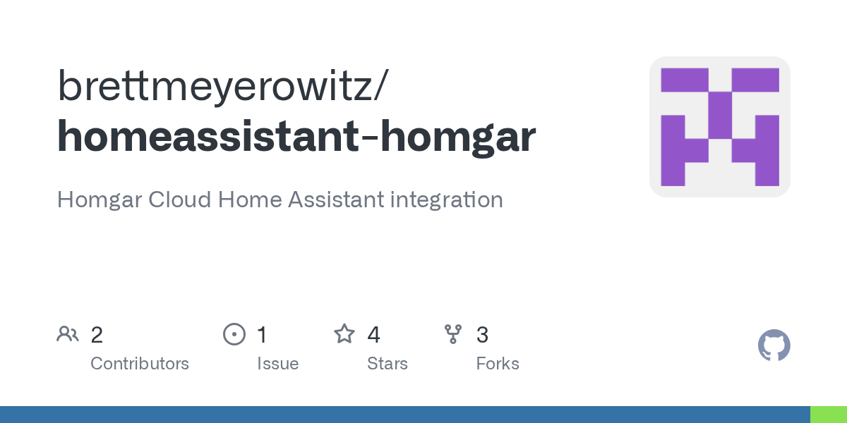

You’re in luck @bouchal ! There is a new, pretty full-featured Rainpoint / Homegar integration for HA. I know it supports the HTV213FRF (since I have one) and I believe it supports your other device too. The developer is really responsive as well. He’s added new devices and fixed bugs for me in a matter of hours. You might want to check it out:
