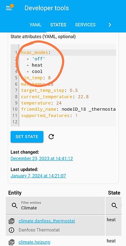

Hi guys, I desperately need your help and some guidance. I have an EvoHome system comprising 12 individual zones each one with its own DT92 thermostat. I have an HGI80 connected to Home Assistant and ramses_cc installed through HACS. It recognizes all my zones and temperatures readings are ok. I have also tried to make some automations that turn the heat off in case an window is open for a zone by using a community blueprint: Window open, climate off - Blueprints Exchange - Home Assistant Community (home-assistant.io), and some Aqara door and window sensors. However it seems that the ramses_cc integration is only exposing 2 modes: Auto and Heat and does not expose the Off mode. I have also installed the cloud integration for EvoHome and there I have the Off mode exposed and the automation based on the blueprint above is working, except that I do not want to rely on cloud and would prefer to have everything local. I will attach 2 print screen for the same thermostat, one coming from ramses_cc and the other one based on EvoHome cloud integration to see the exposed modes. What am I not getting right here and how can I make the ramses_cc exposed climate entities work with the automation above? Thanks a lot in advance!
Please check what hvac_modes: are supported under Developer Tools → States
Indeed it’s only auto and heat, what can I do?
And this is for the cloud integration with EvoHome:

The mapping between evohome modes and HA modes/pre-sets (and thus, HomeKit / Google / etc.) is not straight-forward.
For example: zones are never truly ‘off’. They only have three modes:
  • FollowSchedule
  • TemporaryOverride, and
  • PermanentOverride
However, the TCS (the controller, i.e. a collection of zones +/- DHW) can be off:
  • HeatingOff (the DHW remains on)
I think the obvious thing for a zone to be set ‘off’ is for it to be set to 5 'C indefintely (PermanentOverride) - but others may disagree.
And the difficulty is not so much turning a zone ‘off’, but working out when it is ‘off’…
You could easily say a zone is ‘off’ if it’s setpoint is 5 ‘C (and what is the relationship of that to the zones min_setpoint - I have never fully checked), but there are 4 reasons why a zone setpoint can be 5’ C:
  • PermanentOverride - set to 5 indefinitely
  • TemporaryOverride - set to 5 for a while
  • FollowSchedule - set to 5 as per schedule
  • OpenWindowMode - is any PO/TO/FS, but set to 5, regardless of setpoint, for a short while
[ There are other reasons why a zone’s TRV can be set to 5’ C! ]
Then, what part does the TCS mode play? What happens if the zone is FS, set to 5 'C, but the controller is (say):
  • Auto
  • Away
  • HeatingOff
I am the ‘code owner’ of HA’s evohome integration, and I have long recognized that the mappings I made when first implementing that integration are not satisfactory.
They need correcting, so that integration with 3rd-party systems via HA work seamlessly… But these corrections will be breaking changes.
I have always had it on my to-do list to fully understand what changes are required & implement them - but I want to do it only the once - get it right first time.
TL;DR: I would then like this integration, ramses_rf, to be compliant with evohome, and for them both to be ‘right’, but doing so is a breaking change, and I haven’t got my head around it.
