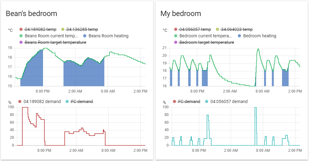

The evohome integration shows a shaded are for each zone’s heat demand (upper graphs) - TBH, this is a bit of an educated guess. evhome_rf does it accurately (lower graphs):
Note the temps in the upper graphs are the room (zone) temps, no the TRV (device) temps.

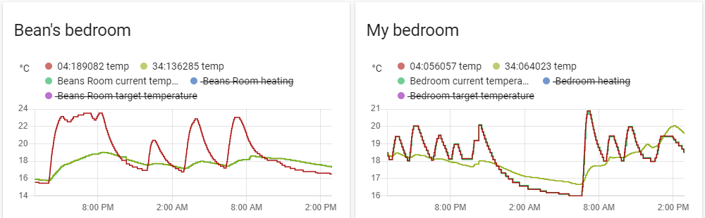

This one compares a room with a thermostat, to one without:
In the left graph, the 34: device is a round thermostat in the zone, and the room temp overlays it 100% - the 01: device is a TRV.
In the right graph, the thermostat is in the same room, but is not part of the zone, so the zone temp is coming from the TRV.
Sorry, but for some reason, target temps are not graphing properly, so aren’t included.
