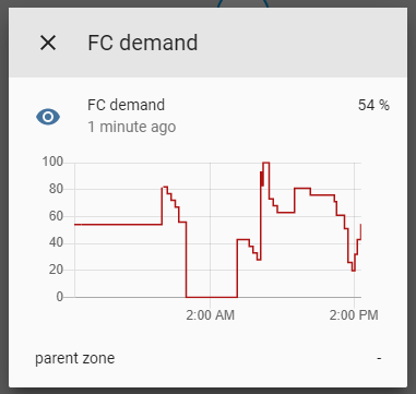

sensor_00.demand
is an orphan - it is not the controller, nor a zone (a zone’s demand appears to be the highest of all it’s constituent devices)
sensor_FC.demand
is the system demand (of heat) - this directly affects the TPI cycle - it appears to be the highest of all zone demand.
Well-spotted! Without the exact figure, I cannot say 100% what’s going on, but here are two reasons I know of when a zone / zone device may call for heat even though the zone temp is above its setpoint:
- is it still in the dead band (less than 0.5C above the setpoint temp)
- it is pre-heating the zone
Note the call for heat (shaded area) in the RESTful version of evohome is under-represented - I am planning to remove it - the only way to get that data will be to use this integration.
