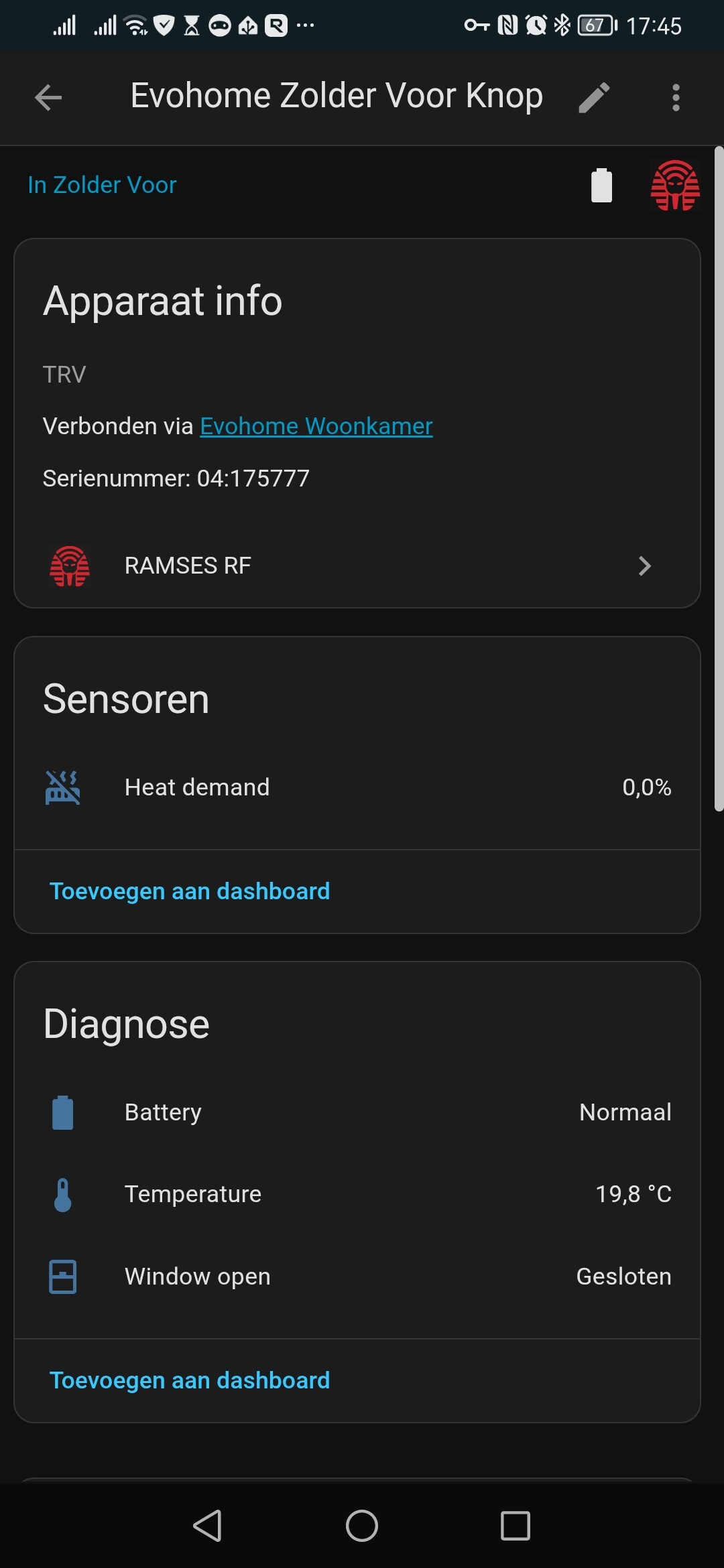

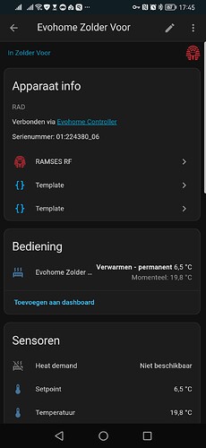

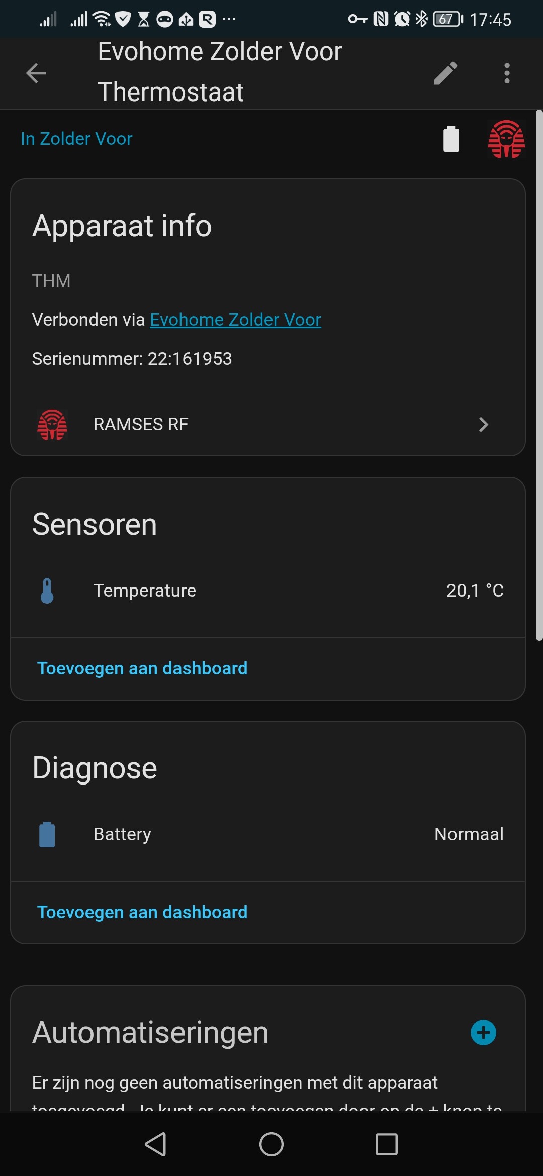

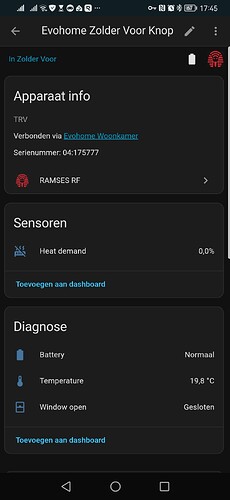

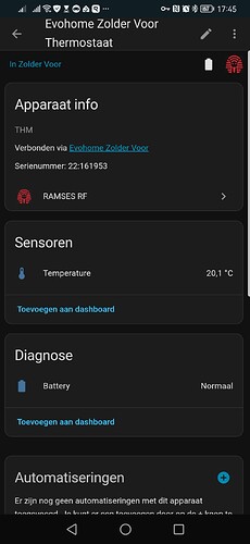

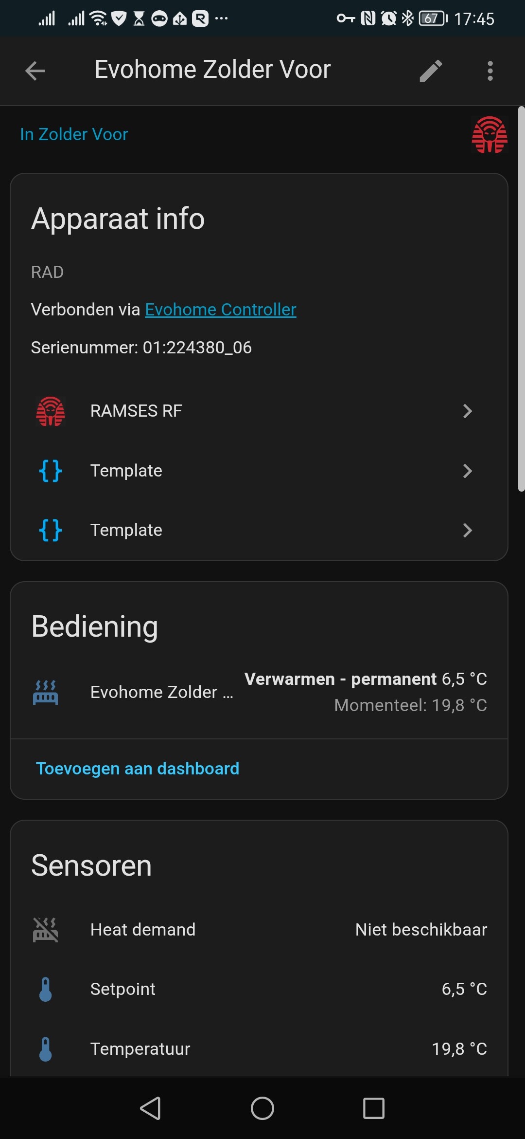

In my case the issue of the missing demand is there for months, where in HA is rebooted several times so it doesn’t solves itself in my case. I’ve investigated it further.
I have a RAD, TVR and THM in this zone “Zolder”.
  • The RAD is connected to the controller and has a heat demand which is unavailable.
  • The TVR is connected to the (zone?) “Woonkamer” and has a heat demand with a value.
  • The THM is connected to the RAD “Zolder” and has no heat demand.
It seems like the problem is that the TVR it’s connected to the wrong zone. But in Evohome itself it functions correct. Also deleting the zone, and recreating it in Evohome does not change anything in HA.
