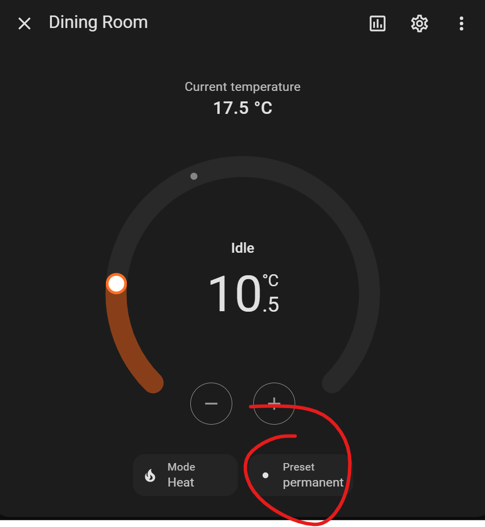

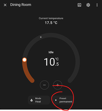

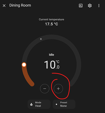

Hey Egbert, I am running the latest release and I have noticed the default behaviour on the temperature setpoint has changed from “temporary” mode/preset to “permanent” mode. I believe this change was introduced during the recent fix Cannot create a temporary temperature override via the UI climate control (Evohome) · Issue #297 · ramses-rf/ramses_cc · GitHub
The old behaviour was that when you changed the temperature without selecting the preset/mode it would use the “temporary” mode be default.
However, since this change, it now defaults to “permanent”. I believe the old behaviour of “temporary” should be used.
Yes, that is the issue/change. Peter’s evohome didn’t pick up the next scheduled change, hence the request.
What Controller do you have that responds as you describe? Please enter that in the issue, which I reopened.
