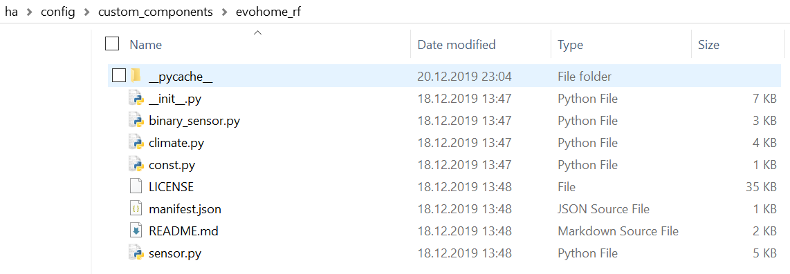

I also installed the ‘cc’ in ‘hass.io’.
Plus followed this to install on ‘Debian LXC’.
Also I made entry in ‘.yaml’.
But not sure what I should do next.
Ex. in ‘hass.io’ log I see something like that:
Config = OrderedDict([('serial_port', '/dev/hgi80'), ('packet_log', '/home/zxdavb/packets.log')])

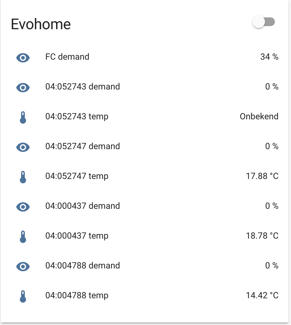

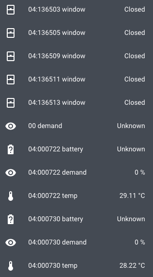

I’ve got a ton of sensors to sort through. How do I tell which one is which? Would be interesting to compare them to existing ones… I guess I could graph all the old and new ones and compare if there’s no easy way.

04: is a TRV, and it is in the main room.

Okay, the parent_zones are showing as null now, but I will wait and see. No way to tell which sensor is which within a zone once the parent_zone starts populating?
It’s interesting, some of the TRV’s are showing much higher temps than any of the zones… I’m assuming those are the ones that use external thermostats since they are covered by curtains or in the floor with the convectors.
Each Zone has an ‘authorative’ device that is the zone temp - say a round thermostat. The TRVs temps can vary widly. Have a look at Honeywell evohome via RF (HGI80/HGS80) for an example.
With HA, you can put the zone temp, and teh device temps on the same graph.
The parent zones may take a while - the system has to wait fro the right packet to appear - some of them are only sent once a day.
Are u using the very latest version - there was a bug with parent_zones, now fixed.
