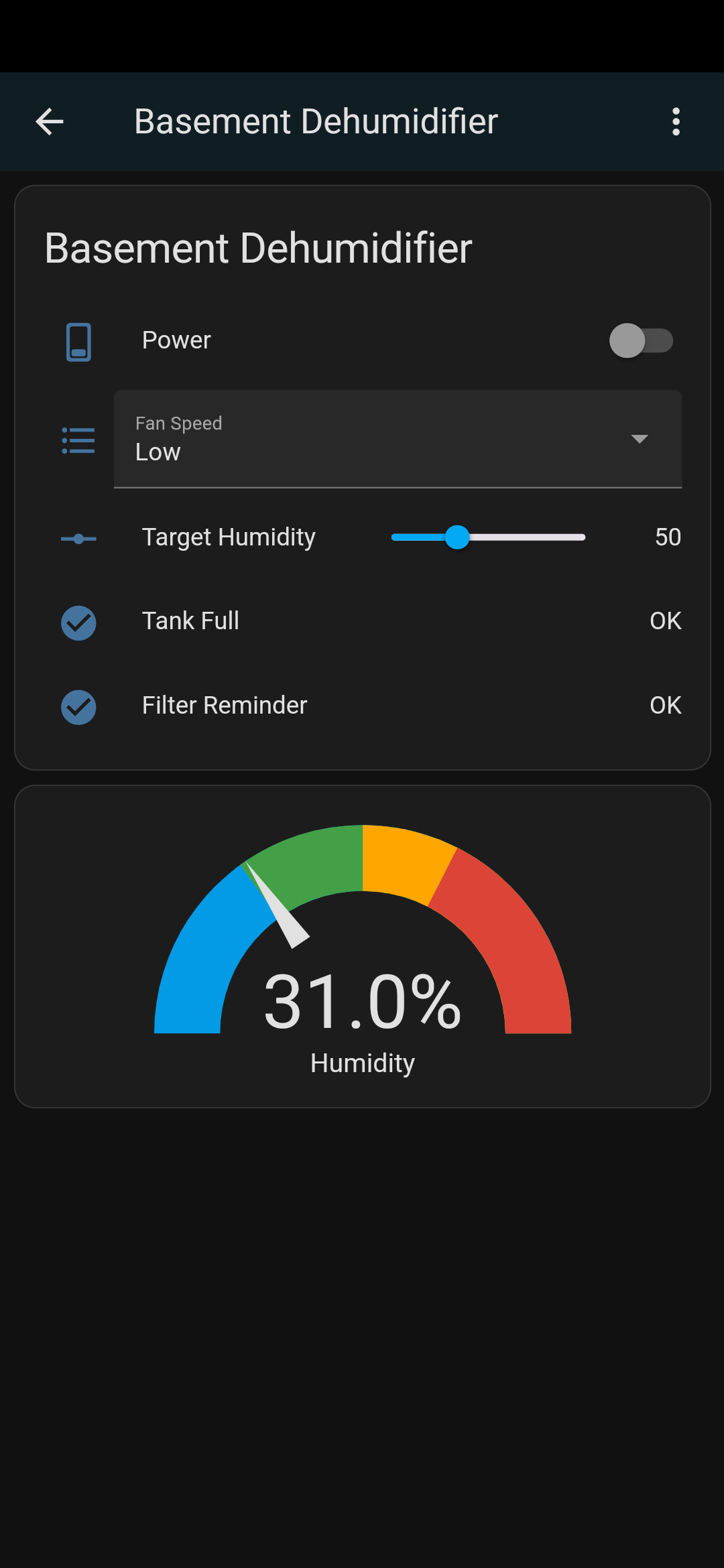

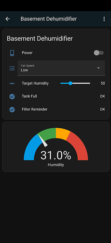

So honeywells branded app is just a reskin of the smart life app which is one of the apps used with tuya. The dehumidifier was able to connect to that app instead so is really just connected to tuya. And I was able to use the tuya integration to connect to my smart life app account. However the tuya integration doesn’t support dehumidifiers yet. I’m holding out hope that they eventually add support for those devices.
