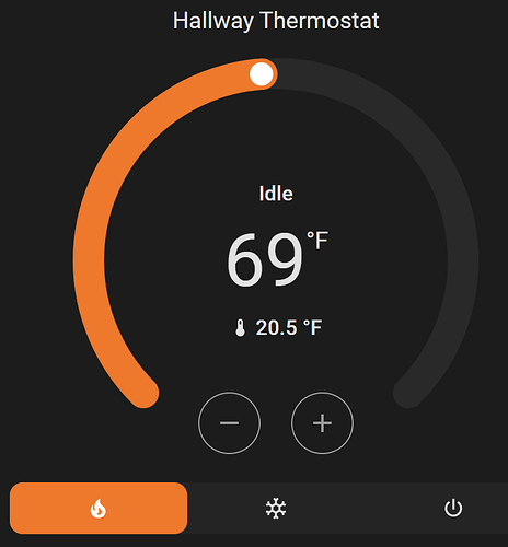

I am using a new setup using ZwaveJS controller latest version. Any info appreciated. The card show 20.5F but it must be Celsius. I am using Zooz 800 Series Z-Wave Long Range GPIO Module ZAC93 LR
- Make sure configuration parameter “Temperature Scale” is set to “Fahrenheit”.
- If using Z-Wave JS UI, set your preferred temperature scale to F and refresh the temperature value. https://community.home-assistant.io/t/wth-is-going-on-here/561562/13?u=freshcoast
- If not using Z-Wave JS UI, try executing this service call, which will force ZJS to request the temperature in F. https://community.home-assistant.io/t/wth-is-going-on-here/561562/16?u=freshcoast. This should persist.
Thank you. I do not know what happened but now it is reading correctly after about an hour but I did raise the setpoint one degree. Then it starting reading OK.
That Celsius thing will happen every now and then until you set the preferred measurement systems as @freshcoast describes.
Thank you…good to know. I am migrant from HE and really like HA btw. ![]()
