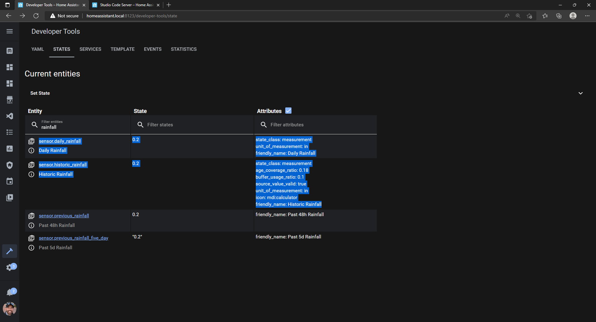

Ok. So I just took a look at both the “historic rainfall” and “daily rainfall” shown in my earlier screenshot. It looks as if both have the value of yesterdays rainfall. So I believe writing to the sensors is happening properly.
“Historic rainfall” is my statistics sensor. “Daily rainfall” is the sensor I am storing the rainfactor day 0 rain to each time it rains based on the pattern you gave me in the template. (I believe this happens at midnight each night)
For Historic Rainfall, is “max_age” 24 hours ok? Below is the snippet from the statistics page regarding max age. I almost feel like I shouldn’t include it at all. The reason I say this is, if I am wanting an historic graph of rainfall, I believe it is deleting anything from the statistics sensors older than a day which means its only going to store one day and a time and discard all previous entries. What are your thoughts on this? I may be completely wrong (I believe the original code you sent me around the statistics sensor had this set at 48 but I’m thinking the same concept applies unless I don’t understand what I’m reading fully)
