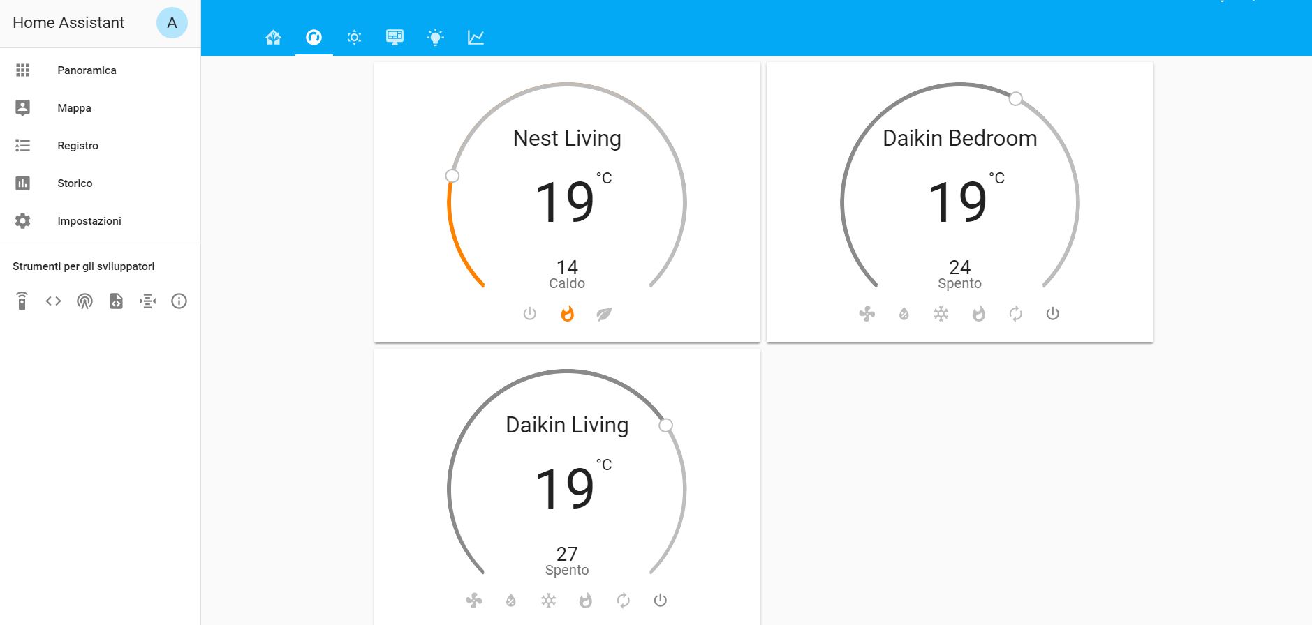

I have tested your configuration… but with 3 x Vertical Stacks I have this problem…
Try closing the side panel…
Lovelace is responsive, that means it will try to fit your screen. With the side panel closed, it should be fine.
no way :(((
That is bad… Your avatar picture would fit perfectly here as an answer :smiley:
I guess you cant do much here… You should go with my suggestion if you want it to look nice horizontally.
yes !!! horizontal has the priority ;)))
Did you try refreshing? I stopped using panel because of the mobile issue. Lovelace can be tricky sometimes but a CTRL F5 of clear cache should fix it.
just done… but only the horizontal stack works :(((
