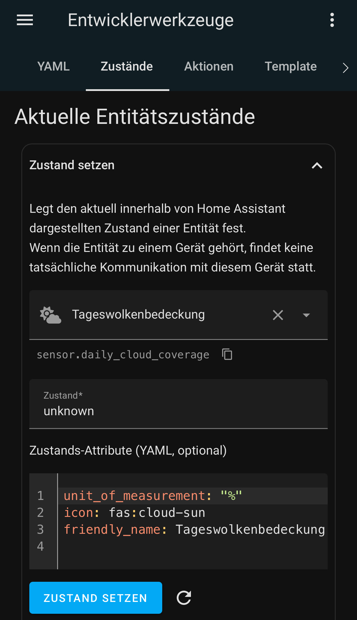

But if I make a sensor from it as follows…
- platform: template
  sensors:
    daily_cloud_coverage:
      value_template: >
        {% for hour in state_attr( 'sensor.weather_forecast_pv', 'forecast') %}
        {{ hour.cloud_coverage }}
        {% endfor %}
      friendly_name: "Tageswolkenbedeckung"
      unique_id: daily_cloud_coverage
      unit_of_measurement: "%"
… I get no values displayed:
Since this is, as already mentioned, my first templating attempt, I hope you can help me to get the cloud-coverage-sensors values…
Thank you again!

As I said, the way the template is now the sensor can hold exactly one number in its state, not six numbers in one string like your template outputs. If you want the full text with the six numbers, then remove the unit_of_measurement line. Without it the text is allowed.
If you use an attribute to hold the information then you can have multiple numerical values in a data structure like the original example. But then you need to change the template to something more akin to the original template.
