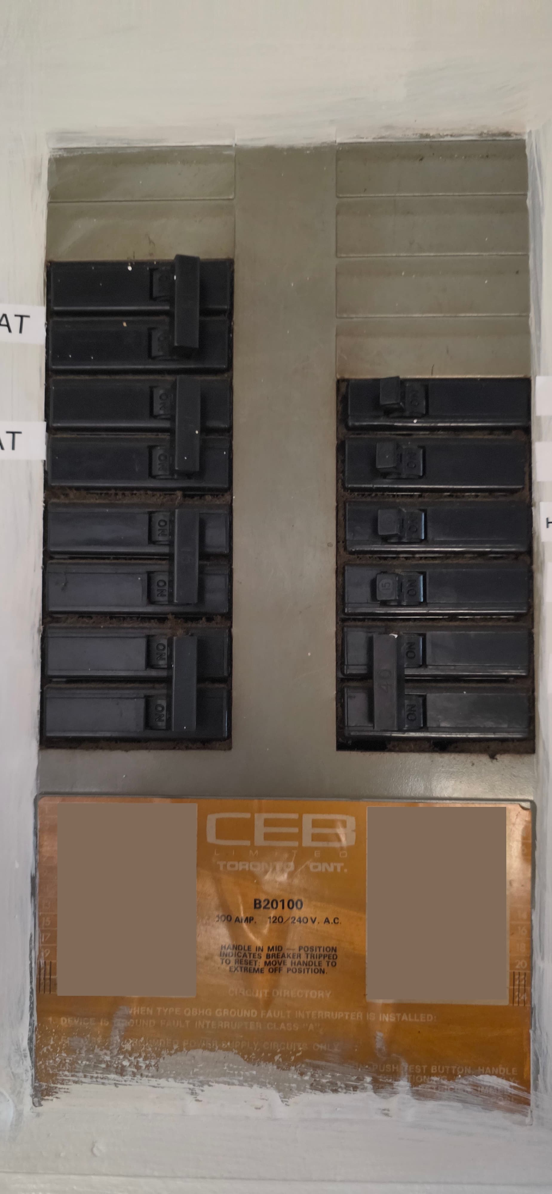

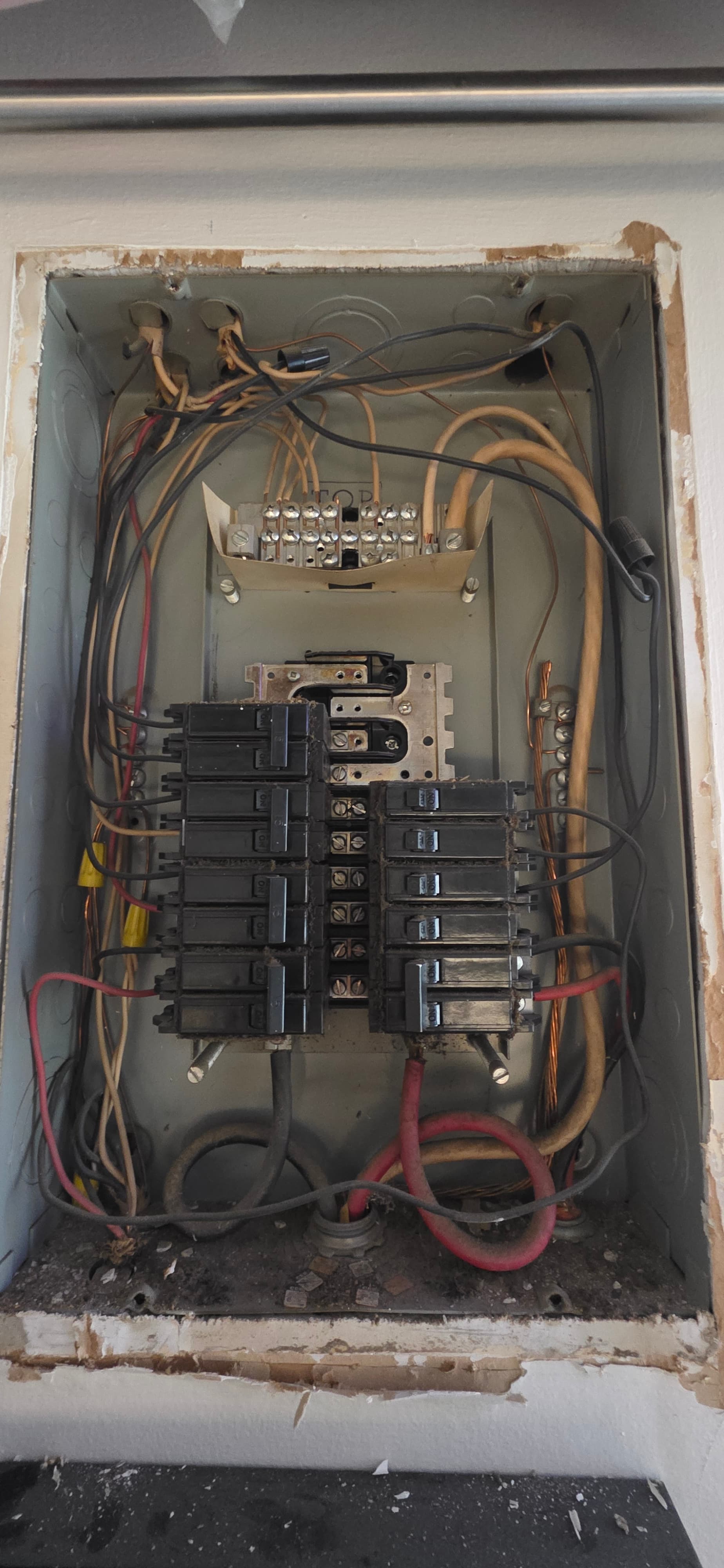

I was curious to know how I could swap out my circuit breakers with smart ones, and which ones would work best with Home Assistant? I haven’t the slightest clue how to research circuit breakers so some guidance is very much welcomed! I have attached photos of my breaker to assist anyone who might be able to point me in the right direction! Thank you in advance!

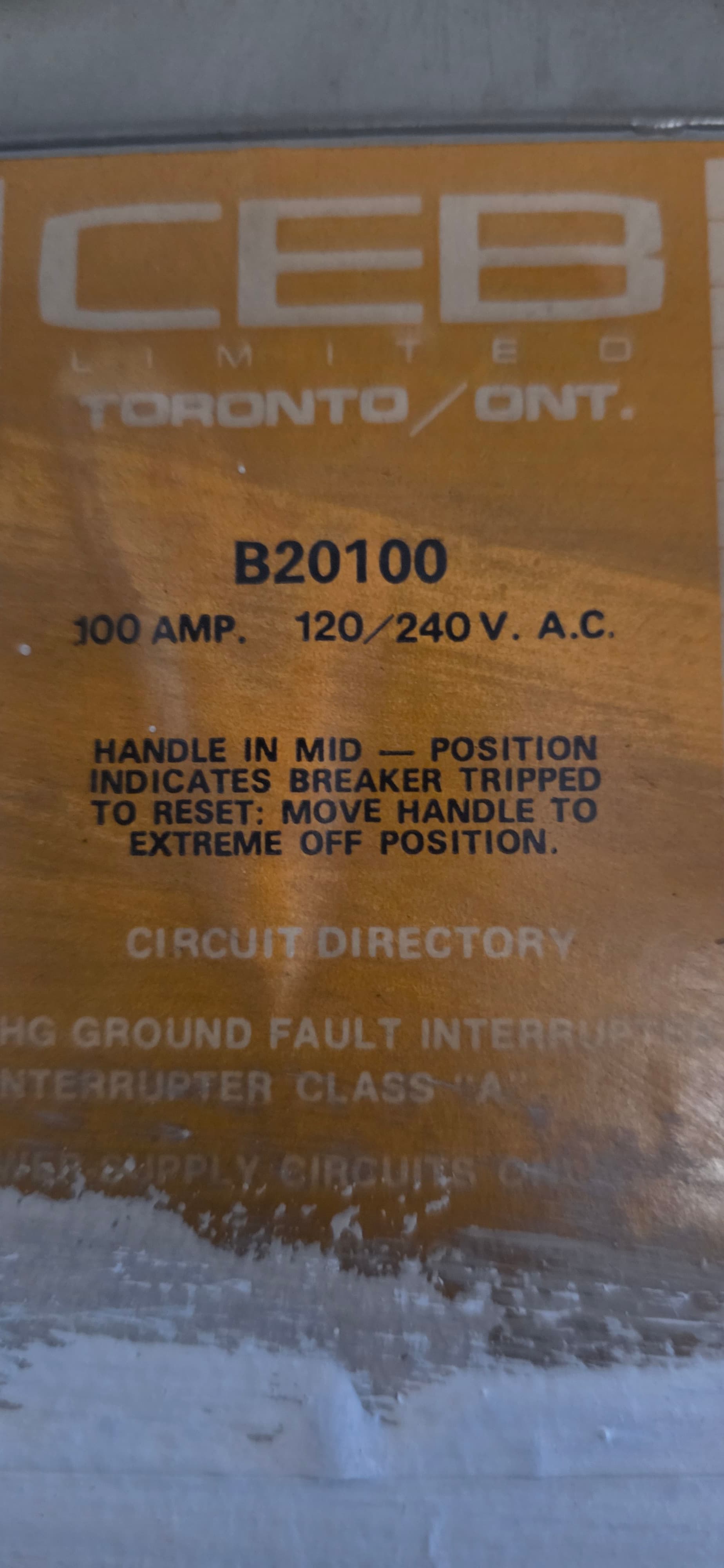

The photo shows kit labelled form Toronto, Canadia , but assumptions with power engineering kill.

Our service is 120 Volt (You will see double circuits, they are for my baseboard heaters (240 Volts)

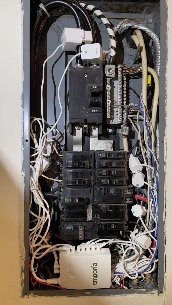

Thank you everyone for your input! And I agree with all of the points made. I didn’t know there was such a thing as clamp on monitors. I have taken a photo of the inside of my panel and see there is tons of room for them! So I will look into this option instead! Thank you!
I have a main and 2 sub electrical panels, and each has an Emporia Vue device in it so I can monitor every circuit breaker. I agree that it being cloud based isn’t ideal, but I’m not prepared to go cloud-less at this point in time.
It’s worked out very well for me, and has helped me save a lot while identifying some issues I needed to have addressed.
