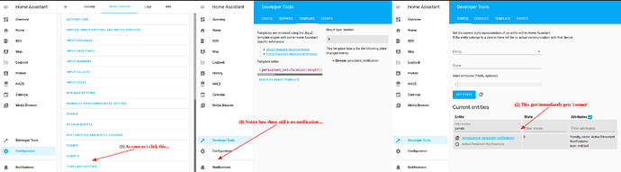

After waking up and making my way into the kitchen for some coffee, I noticed the indicator light was blue. Since my computer was still asleep, I used my phone to check what the notifications were:
Before dismissing any notification, I woke up my desktop and prepared to start taking screenshots / documenting.
I pulled up three instances of Lovelace and then dismissed went back to my phone to dismiss the “withings failure” notification.
I used my phone to dismiss because I wanted to rule out any websocket related issues. As soon as I dismissed the notification on my phone, the notification badge count dropped by one on my mobile and desktop. It is safe to say that there is no problem with websockets here; a button press on one device is reflected in real time on the other.
Look above, I want to call your attention to a few things:
- The notification badges are correct.
- The template sensor is not correct
- The template evaluation in dev tools is correct
After collecting and annotating that screenshot, I dismissed the only remaining notification; the shelly fw notification:
This time:
- The notification badges are correct; now reads 0.
- The template sensor is not correct. It isn’t an ‘off by one’ error… it straight up did not get evaluated!

So then what would it take to force the template sensor to be re-evaluated!?
I went into server controls and reloaded the template entities. The template sensor was updated and the notification light went from blue to off. Success!
