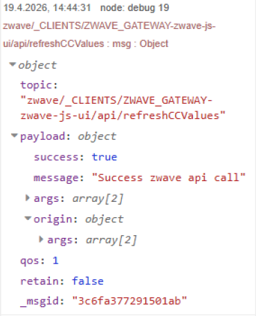

The message that is received by Node-RED is this:
In Node-RED, a switch node checks if msg.payload.success contains true, and if it does sends the message “Z-Wave is alive” to the keep alive system. I am using a persistant notification to find the correct way of using the payload, but I’m failing miserably. This is the code:

I thought that payload_json.success would be the correct, but traces gives me this error:
Feil: expected dict for dictionary value @ data['data']
Resultat:
params:
  domain: notify
  service: persistent_notification
  service_data:
    title: '2026-04-19 14:58:01.495285+02:00'
    message: |+
    data: trigger.payload_json.success
  target: {}
running_script: false
If I only use trigger.payload_json I don’t get the error, but I get a notification that only contains the time and date. Can somebody please tell me what I’m doing wrong here? This is a JSON payload, right?
