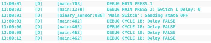

I want to be able to access the value, both to print out in logs, and to use the value in other functions and statements. For logging, I’ve tried:
      - logger.log:
          format:  "DEBUG MAIN PRESS 2: Switch 1 Delay: %i"
          args: 'id(Switch1Delay)'
This is part of a Binary Sensor that response to a button press. When I press the button, I see:
(Relevant lines are the 1st and 2nd line in the log.)
The value is currently set at 120, but when I try to log the value of it, I get 0, so I’m not actually getting the value when I try to print it in the log. I would think %i would be the right pattern to use to print an integer - is something else better? Or is the problem in the next line?

Then I compiled and ran it and it’s reporting the value as 0, not 11, what it’s set to:
I boxed in the relevant parts in red. The value is set at 11 on the Template, and the log is reporting it as 0.
I even did a search to be sure the logging part was using the same spelling and referring to the specific Number Template I wanted to use. (There are 8 number templates - all set to 120 except the one I’m testing, so none should be reporting a 0.)
Try %f
Working with %f.
