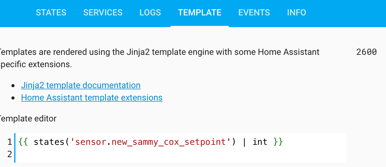

Here is screenshot showing the template output:

I solved my problem. It (as to be expected) was a “dumb user” problem. I should have used data_template instead of data.
