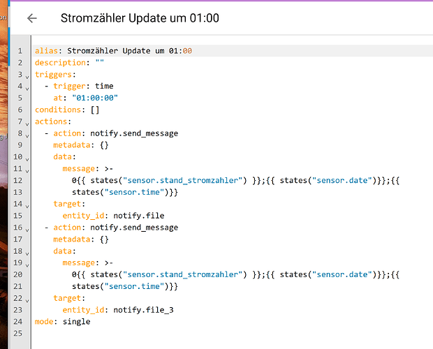

Not sure if this will help, but I am writing to a csv multiple times a day without problem.

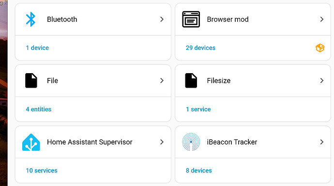

I did not do it through yaml, but instead I used the “file” integration:
Just hit “add entry” - give it a path - and you are on your way!

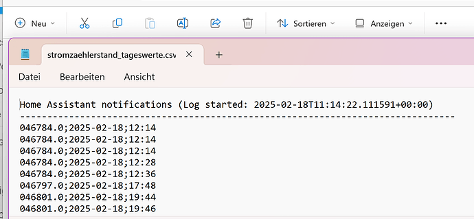

In your automation to write to the file you just have to specify the number of the file. In my example I am writing to the first file and the 4th file (as shown on the list from the top):
The result looks like this in the csv - it appends every new entry in a new line:
