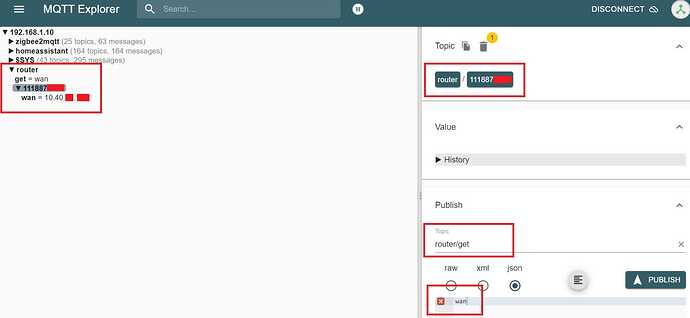

Hi, I would like to create a Mqtt sensor that asks my Router for the external IP address every hours.
With Mqtt Explorer I tried to make the request to the router, like this:
In Home Assistant, how can I create this sensor?
I tried this way but it doesn’t work.
This is my first time trying to create a Mqtt sensor

Try this, replacing ??? with whatever’s under the red box:
mqtt:
    - name: "Teltonika RUT Wan IP"
      state_topic: "router/111887???"
      value_template: "{{ value_json['wan'] }}"
Note the underscore in value_json; and little point concealing your private IP addresses. A 10.x.x.x IP address isn’t public.
That’s the sensor, though — the router is publishing that for you to read. You talk about making a request?
