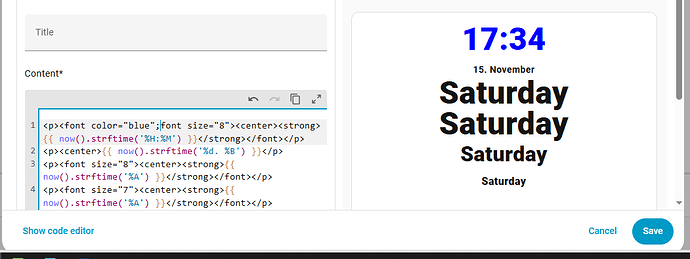

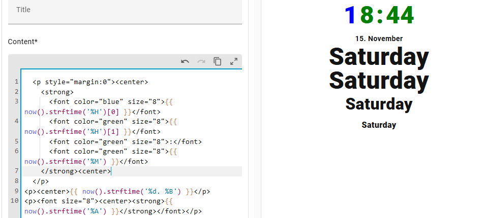

< font color=“blue”>text is blue< /font >
You can try use “…”
See above about font color, it is considered as deprecated and does not support variables. Although it works with named colors…
