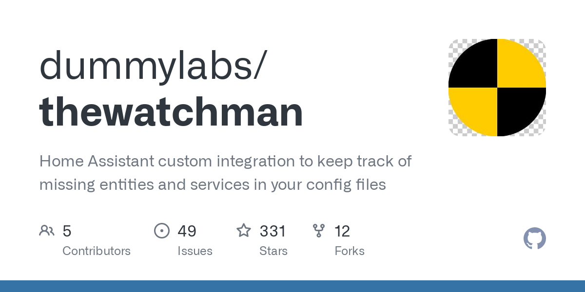

Edwin_D
(Edwin D.)
January 6, 2024, 8:59pm
7
Watchman will hunt down entities in your yaml that do not exist or are unavailable:
