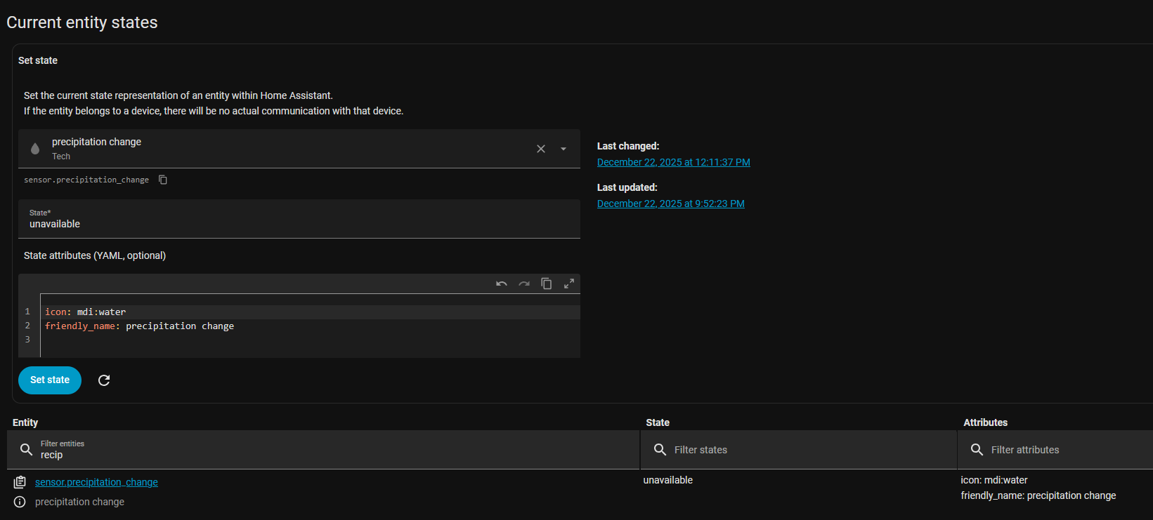

Does the entity not get created or is it just that the state is unavailable?
Search for “sensor.precipitation_change” in Developer Tools → States. What do you see?

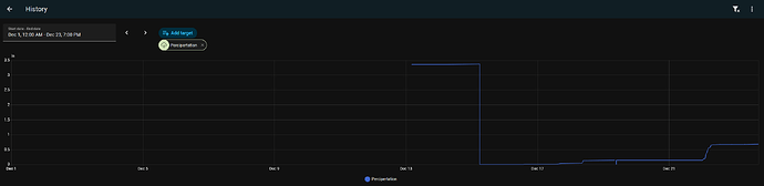

Apologies for not including the correct information sooner. Here is the source sensor:
This is the change sensor:

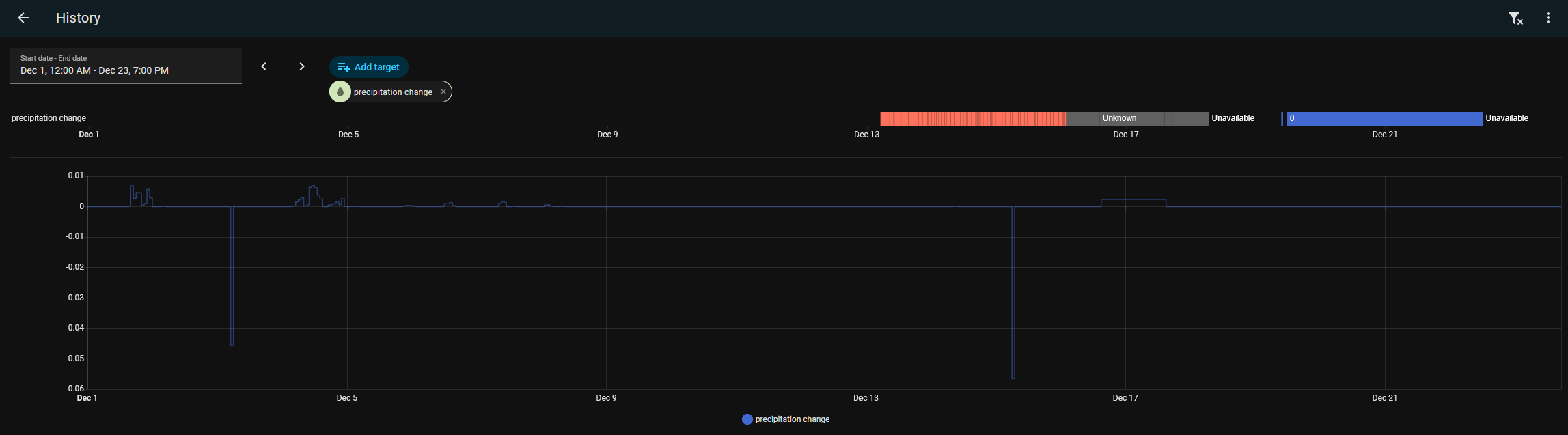

I thought the force_update: true in the sensor would grab the value reported from mqtt every time and the change sensor would just report a 0 if there was no change.
I swear that is the behavior of the past.
Looking at grafana, the change used to report zero or at least something grafana could sum. Then once the change sensor went unavailable, the data source was no longer valid.
From your sensor.yaml:
According to your source sensor screenshot, the entity ID is
sensor.percipertation
Yep, I am not sure what that has to do with this? I misspelled precipitation back in 2022 and never caught it haha
precipitation, percipitation, percipertation. Three different spellings. Your statistics sensor won’t work unless it refers to the correct one.

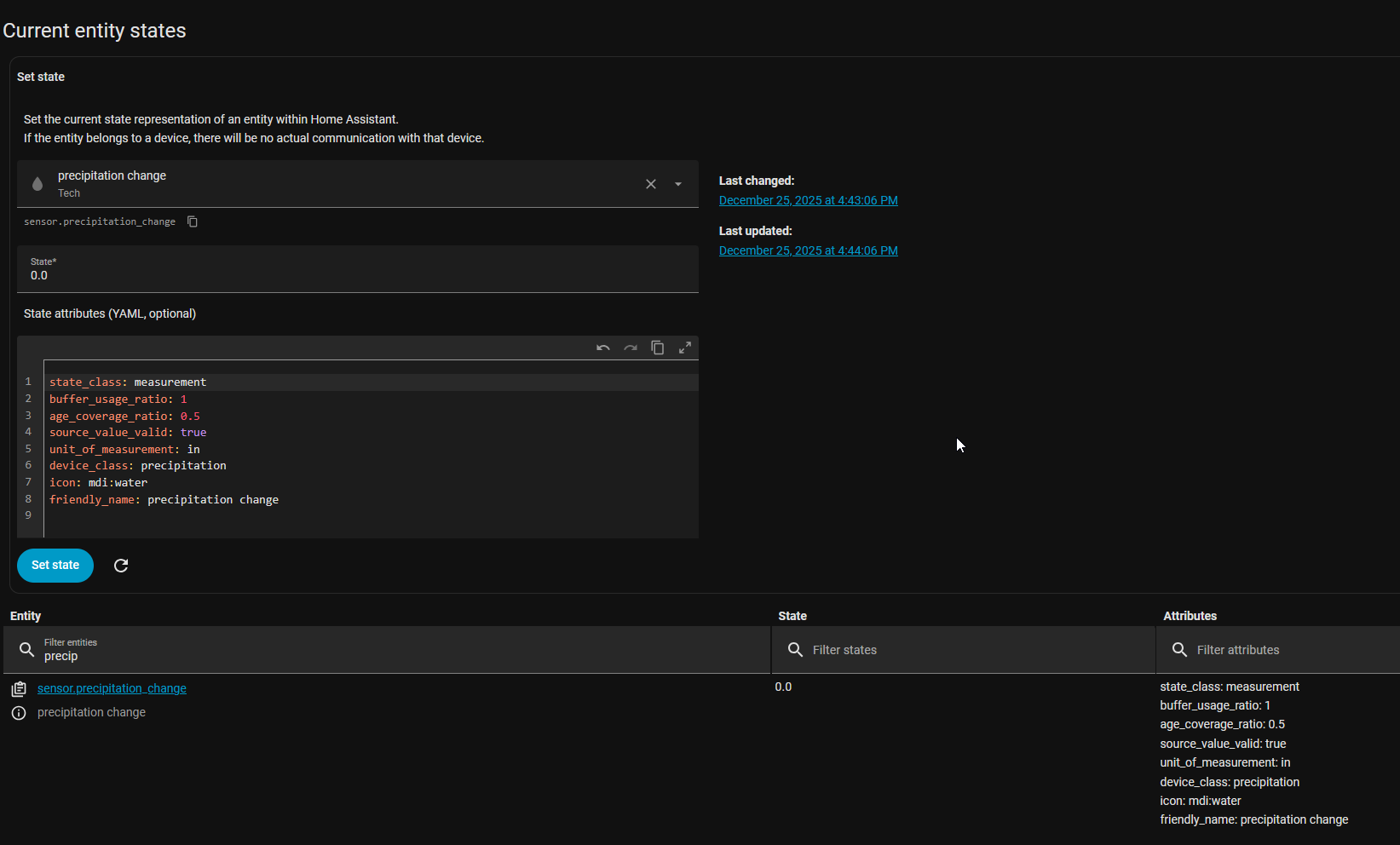

Its working now…Wow I feel like an idiot! Thank you @mekaneck and @tom_l for the help!
