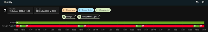

The Hall Light Plug Light entity State attributes
supported_color_modes:
- onoff
off_with_transition: false
off_brightness: null
friendly_name: Hall Light Plug Light
supported_features: 8
