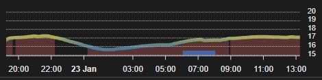

My tado setup gives me near real time updates of the level of heating that the boiler is set to:-
And
I’m not sure what you mean by " it would be interesting to see, if it is burning (heating) right now or if it is only opening the thermostat."
When the tado thermostat (wired or wireless) ‘clicks’, its reached either the turn on or off temperature, which sends a message to the boiler to start or stop.
For me the “_heating” sensor provides this, if it is non-zero the boiler clicks on.
I use it to show red when the boiler is on in my heating graph.

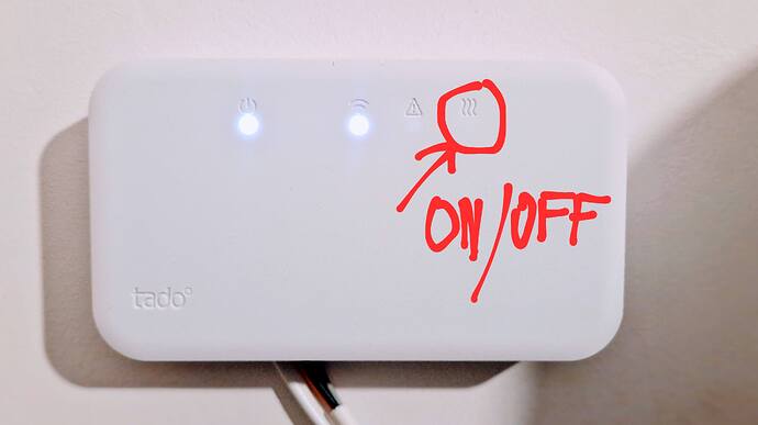

It’s been almost a year since the last comment in this thread and I’m very curious if anything has changed in the situation. I have 4 valves and 2 TADO thermostats. I miss information in HA on whether the central controller requests heat from the boiler or not (see the photo):
The need to install an additional device between the boiler and the TADO controller just to provide HA with this information seems stupid (and extremely redundant). Has anyone managed to solve this problem?
Hi @elemelek, I managed to solve it in a stupid and redundant way and I now have great per second accurate data for when Tado calls for heat and when the Boiler actually on. Here is a little screenshot. Enjoy.

Just to share how I came up with a solution (unfortunately, also with a redundant 10 bucks additional relay) - so far, everything works fine: HA has all the necessary information about when the boiler is running or not, plus additional options for automation provided! :slight_smile:
