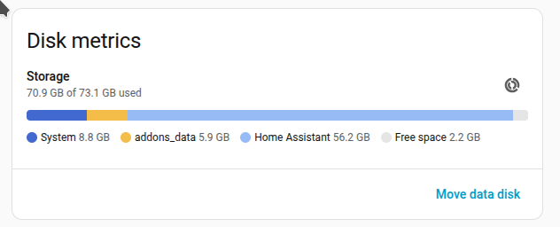

I have a VirtualBox HAOS image which is ~75GB in size and shows HA taking up 56GB and my problem is I need access to a USB device and VirtualBox keeps locking up so I want to move it to an rPi. I've tried KVM and have it working on KVM but it can't do bridging over WiFi and I've not been able to get the networking setup so my espHome devices are connectable since they are on the WiFi subnet which is different than the LAN network. So trying a 4GB rPi 4.

My backup is failing because of disk space and it's likely wanting to store a 33GB backup file and I don't have the space. I've even run a command from the VM login which said it reduced the /mnt/data partition by 52GB but nothing I've found actually shrinks the image or data usage inside the image.

UPDATE: Apps are only 3GB and the other 50GB are HA system with most being data. I've tried multiple times to purge and repack the sqlite db but it doesn't work because I need another 53GB of storage free. ie the db needs equal amount of free space to do anything. Likely to keep a backup copy should the action fail.

For anyone finding this, the home-assistant_v2.db file contains only the historic data so if you stop ha core and move that file off of the VDI, delete it on the VDI and restart the ha core, then you will have a much smaller full system backup file.
